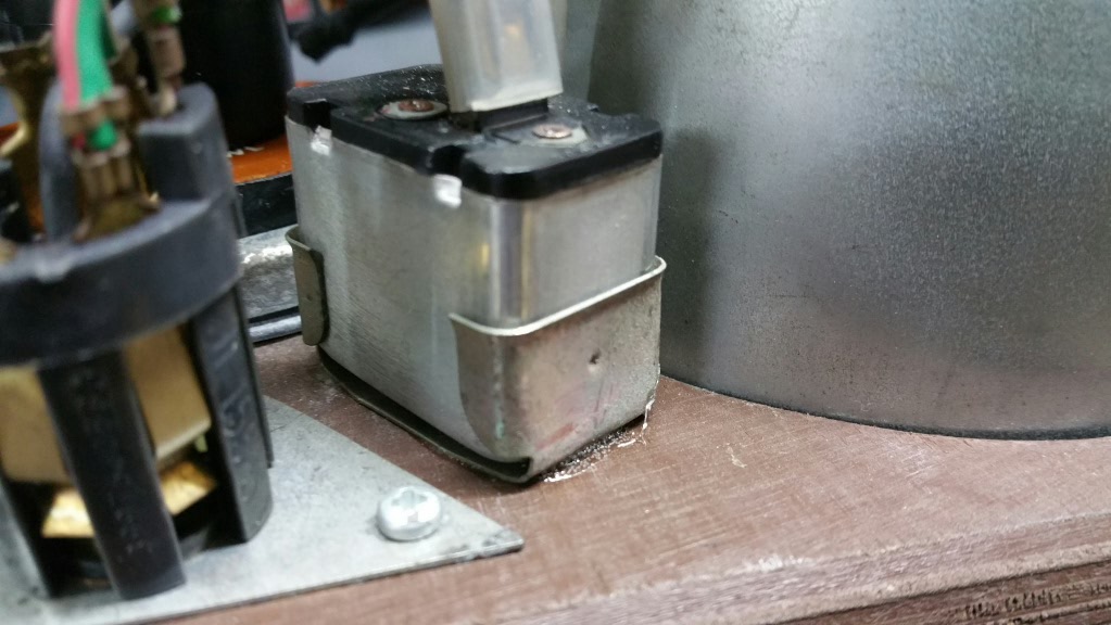

Re: Flat Dash Flasher unit
I know mines a curved sprint dash, but the clips should be the same.
- 2016-06-06 19.17.28.jpg (119.48 KiB) Viewed 1352 times
That looks like mine feels
