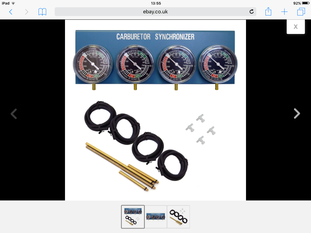

Hi All,
I'm thinking of buying a carb balancer that uses rubber pipes and adaptors that is used to balance side draught Webber and Dellorto carbs
- adaptors and pipes fit into inspection hole by butterfly's
Would it work the same if I used the breather connections on SU carbs by the butterfly's ?
Instead of buying a balancer that goes over the air intake of the carbs
Regards
Regards
- image.png (399.13 KiB) Viewed 1386 times

Given the carb draws air through the front part I can't see why attaching a pipe to a totally different an unrelated part will be of any use. Stick to the normal type. Personally I don't like the Gunson Carbalancers, they're a bit rubbish. There are better made and more accurate devices out there.simonhorton wrote:Would it work the same if I used the breather connections on SU carbs by the butterfly's ?

The last guy who tuned my sprint used one of these
http://www.ebay.co.uk/itm/CARB-BALANCER ... Swxp9W2xyb

I've got something similar (Morgan Carbtune) that I use on my bike, but each carb has it's own vacuum take off unlike the twin SU setups that only have one. I guess you could drill and put one in, bit desperate though!

I use one of these on my SU's and it seems to work pretty well if you don't trust the listening method.

My view is that on Dolomites with twin SU carbs and standard intake manifolds, you have to use a carb balancer, or listening tube, that measures the flow infront of the carb. You can't measure the flow after the carb because there is the manifold integral balancer pipe. If you measure after the carb (or after the butterfly) you are not measuring air passing through the carb, the reading is related to the manifold flow and is affected by the other carb.
Hopes that helps.
Karl.
