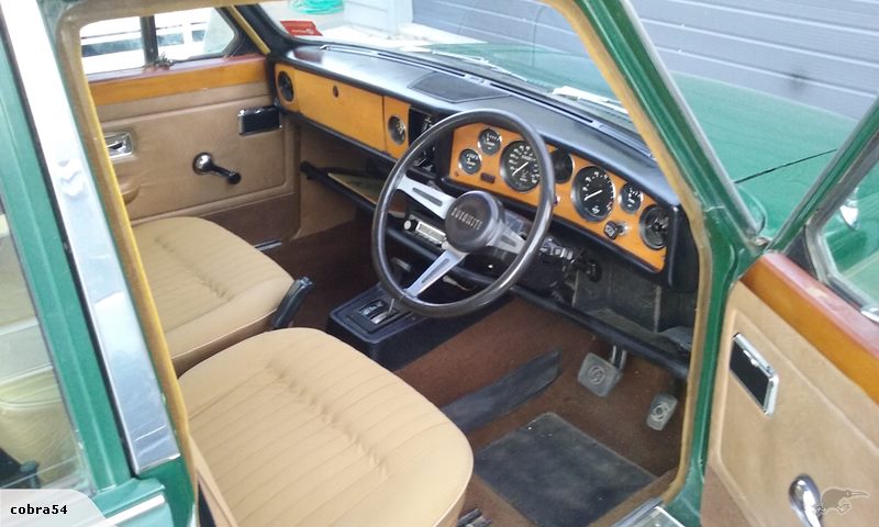

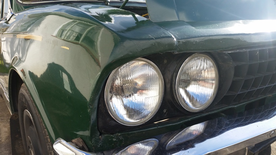

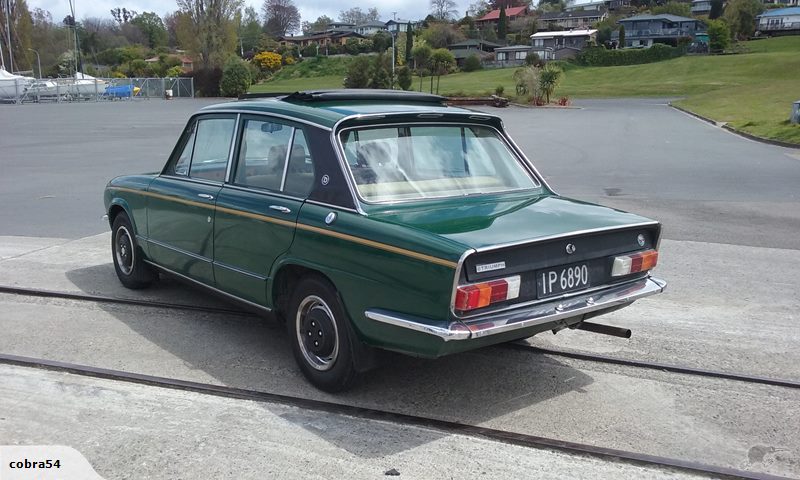

Hello Everyone I will en devour to post an up to date thread of what is happening on IP6890 as it happens.
i will begin by posting the photos i was sent which sparked my interest in this car, and ill include some i took today in this post and hopefully fill you in on what has happened inbetween.
Ill only post the first photos in this post and then give you a rundown on whats happened and some current ones in a second post.
Now since those photos above. the car was driven the 150 miles back to Dannevirke rather without incident except for a chrome wheel trim deciding to part company on the way!

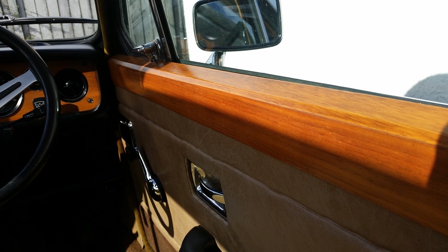

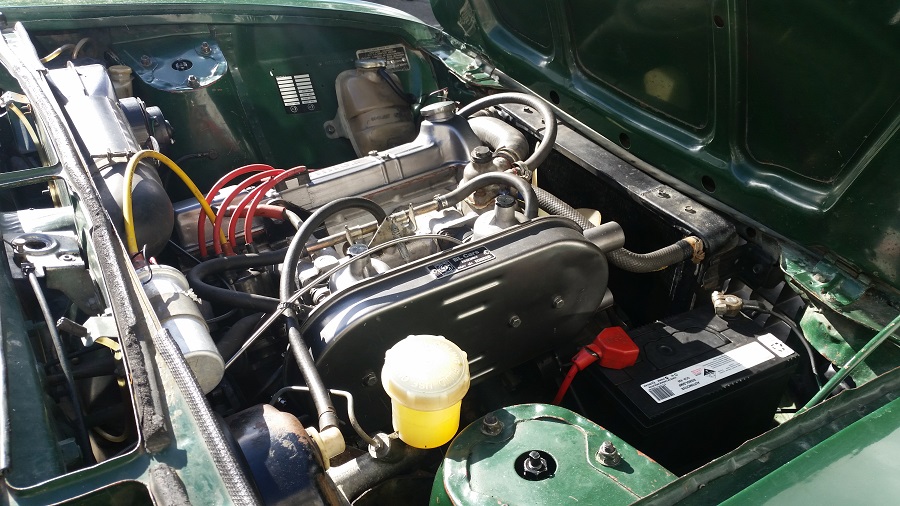

It became apparent alot of engine oil was leaking from around the oil pump transfer housing area so first of all i fitted a new oil pump which came from James Paddock as well as new rack mount bushes (superflex) as they were drowned in oil. however the leak only improved slightly and there continued to be a leak in that area. At about this time the electric fuel pump stopped working so i fitted a replacement one of those and i ordered some seals for the transfer housing from rimmer bros. I have tried to use the car regularly in conjunction with my working 2500TC and while still waiting for the seals one of the rubber carb mounts packed it in and the car ran terribly. so a second order was placed to Rimmers. After i fitted all these new parts the car worked relitively well. I made an attempt to tune it a little better and it was going quite well until one of the new rubber mounts failed... luckily Rimmer Brothers were kind enough to send me a second pair and so far they are lasting! while all this was happening i removed the door cappings and my father stripped them back and restained and varnished them and they came back looking fantastic. I also fitted two new chrome mirrors as the original one actually fell off!

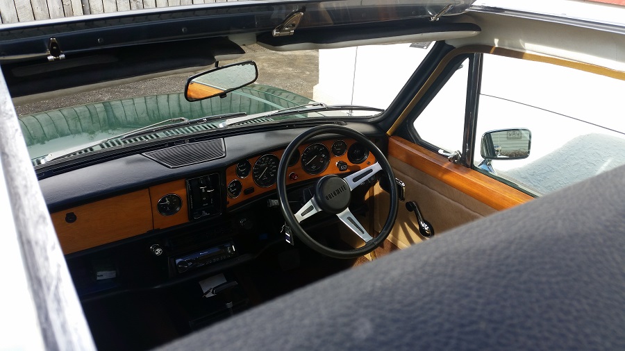

in addition to this work ive also fitted a modern stereo system and a new airel and the correct badging on the boot lid.

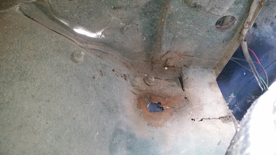

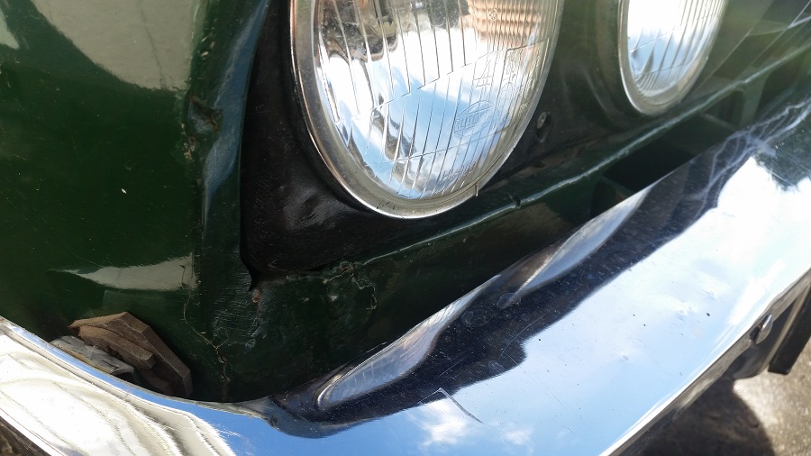

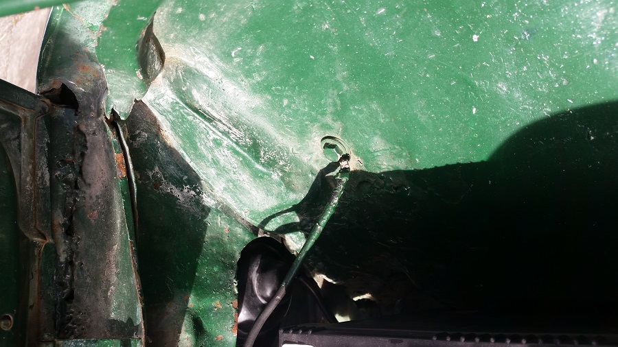

Overall your car looks very good, but the corrosion at the front really needs to be sorted out sooner rather than later.
Also, I would be inclined to change the coolant hoses, especially since you still have the original type wire hose clips.
Furthermore I would convert to Evans waterless coolant, this negates the weakest link of the cooling system, namely
the plastic expansion bottle, because said coolant stays at atmospheric pressure at all temperatures.

I will at this stage leave the cooling system as it is working and not leaking but have taken into account your comments about the hoses.
The corrosion did not cause any concern at the wof inspection. So I will leave it for now, even though it is unsightly. That is the only corrosion damage I've found on the car.

Those carb mounts are notorious for breaking - in fact none of the rubber/metal bonded parts now are much good. I did fix up one pair by injecting (needle and syringe) Araldite deep into the cracks and then waiting a week before installing. That pair are still fine three years later, or if you join the UK Triumph Dolomite Club they sell a whole lot of spares including alloy carb mounts. I have a set of those on another car and they are great. Oil pumps do leak a little and as long as it isn't too much, best just to degrease every once in a while and forget about it.

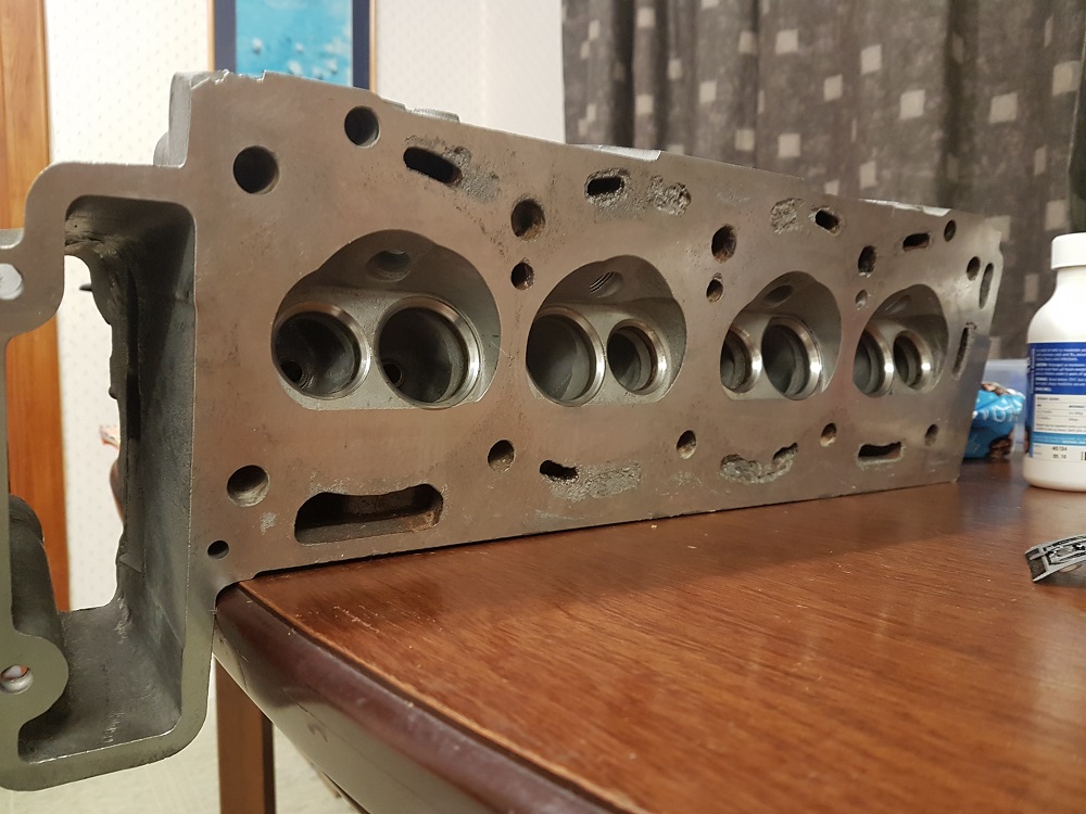

I am midway through an engine rebuild I initially set out to change a few gaskets but curiosity got the better of me and i found myself ordering oversize pistons and bearings...
The car is also at the body shop getting that damage repaired visable in the photos.
I am on the lookout for a few trim parts as I am looking at having the car resprayed shortly
New pistons and rings
Main and big end bearings
New exhaust valves and valve guides
New oil pump
Recon water pump
Block was bored out and the crank was ground to suit the new parts.
the head was skimmed and welded where it had corroded.
