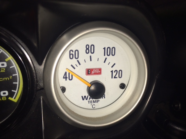

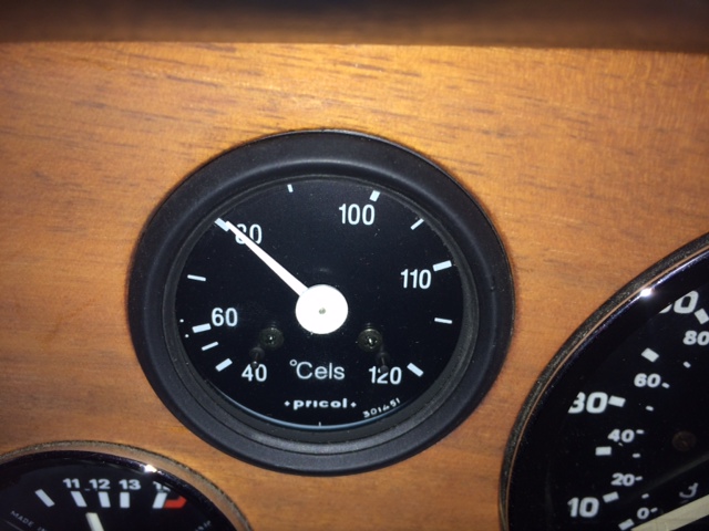

I have an EWC110 fitted to my race car with the latest type controller, mechanical pump and thermostat removed and the bypass tube blanked off etc. I have a Porsche 944T radiator. Controller also works the electric fan. So basically similar to your set up. I've found it all works well and the temperature measurement on the controller is pretty accurate. The sensor for that is in the top hose and is insulated so it is not affected by airflow. Given that ensuring you know with 100% certainty that the engine isn't getting too hot when on the track, I have fitted an aftermarket temperature gauge so I can tell the actual temperature. I have an electrical one in the race car (white face) but use a capillary type in the road cars (black face). I find this helps enormously. Location is in the thermostat housing in place of the standard one and is similarly insulated from airflow cooling.
temp gauge 2.jpg (80.46 KiB) Viewed 771 times
temp gauge 1.jpg (107.68 KiB) Viewed 771 times
I suggest you replace the basic original gauge with something that tells you the actual temperature.
Just out of interest, I run this white faced gauge in a pod of three on top of the dash - the others are oil temperature (measuring temp on the return from the oil cooler) so I can see temperature entering the engine, and also one rigged up to measure pressure in the cooling system to see if the cap is about to blow (15psi).
I've not had any issues with coolant temperature even in very high NZ summer temperatures. I run just rain water with a water wetter/ inhibitor (water of course has a much higher capacity to remove heat than glycol). The great thing is that the pump keeps circulating after the engine has stopped, until the temperature is stabilised at what you've set the controller to.
