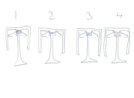

I feel a drawing. Wait for it.
Re: Head work on my Sprint
#10 Post by soe8m »
At first, valves what are too high in the head do also have too much valve spring length. So for performance the right position is importand.
Drawing 1 is a normal situation. The bucket does push on the shim and the shim on the valvestem. A direct contact and the only action is valve open.
Drawing 2 is the situation that 73sprint and Tony have. The valve is too high in the head causing to less play and no shims available. Using too thin shims, not designed for the dolomite engine this situation the bucket can push the upper valve spring seat what causes loosening the valve first and then opening. This is a situation that you do not want and can cause serious engine damage when a valve comes loose.
Drawing 3 is the repair Tony suggested. The only thing what happens is that you can fit a thicker shim what is available but for the rest nothing changes. The bucket to spring seat distance does not change and will never change. You only change the way how you adjust the too narrow valve play what is caused by wrong or too much machined seats. The distance seat/camshaft will never change, whatever you do.
Drawing 4 is a too much machined valve stem. The shim rests on the seat. This way the valve is pushed loose first also before opening. A different way but the same catastophic effect.
As you can see the only way is to have new seats fitted.
#11 Post by tony g »
That all depends on how much clearance is ACTUALLY between the bucket and retainer before you start. My method with normal shims and reground cam has been very good for 2000 street miles driving hard but not 7000 rpm ( well maybe once). Agree to disagree on this as specific set ups will vary. There is no 2 engines the same really
#12 Post by soe8m »
You may disagree but it would not be wise. The thinnest shim has a thickness that the inside of the bucket will never tough the spring seat. Start using thinner than the thinnest std dolomite shim can cause parts touching each other what is undesirable. Grinding the valve stem to use available shims again is fooling yourself. Too much wear is too much wear.
Tony you use a regrind cam and therefore created more play towards the camshaft so you can use normal shims again what does raise the bucket from the upper valve seat. Still not perfect but it is 100% safe. As long the bucket to seat distance is okay.

Mine is more perfect than having big thick shims waiting to jump out at high rpm. When using ground valves retainer to bucket has to be checked of course
#14 Post by soe8m »
More perfect for a reground camshaft but valves up high in the head do miss a lot of flow advantage. A valve on top of a valve seat opening 9mm is open 9mm. A recessed valve in a valve seat that has to overcome 2mm out of a tunnel does has an effective 7mm valve lift/opening. The "open" area around the valve is greatly reduced. So not so perfect.
