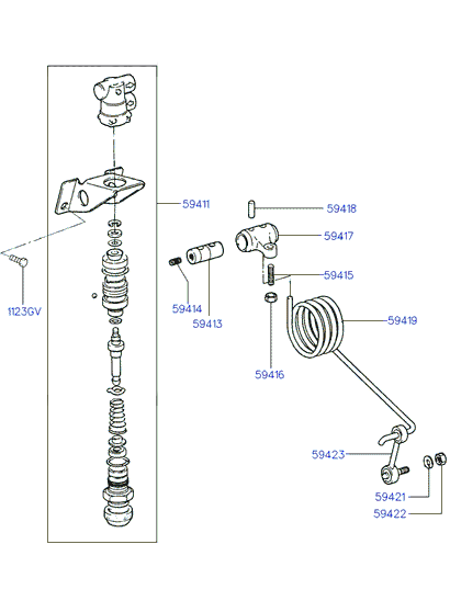

#4 Post by soe8m »
I did shout it here before but an '90 hyundai h100 van has the same lsv as the sprint. Same bracket and even the same rods. A direct replacement. Only the thread of the brake hose outlet is metric but easy to solve with a little adapter union from metric to unf.

#7 Post by soe8m »
Here's the hyundai part with numbers.
