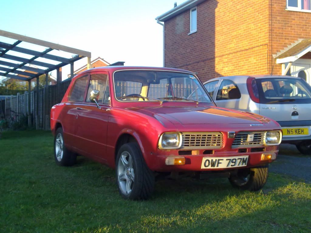

Finally, how not to do it!
My car as first built, with standard Sprint coilovers all round. Not only does it look horrid, the handling and driveability was terrible too!
This is how it is now,
Considerably better, i'm sure you will agree! And now it corners beautifully!

Re: lowered springs with standard shocks?
Wow that really does look like a monster truck on the sprint coilovers! But yes looks much better in the second pic, is that pretty much standard height on the rears?
- Posts: 7249
It's about 1.5" down on stock at the back. (and about 3" at the front) You can go further, but not with the MGF rims! I've rolled the rear arches, but the inward taper on the inner arch means contact if you go much lower. That and it looks tail down if you drop it further, the front really WON'T go much lower, I've nearly lost the sump plug a couple of times as it is! I'm also not a big fan of "slamming" The stance is how it is cos that's how it works best, it's sheer co-incidence that it looks good as well. I trackday this car and for me, function defines form. The second pic may be slightly misleading as the car is parked on a slope. It actually sits pretty much level, front to back.sparker wrote:Wow that really does look like a monster truck on the sprint coilovers! But yes looks much better in the second pic, is that pretty much standard height on the rears?
