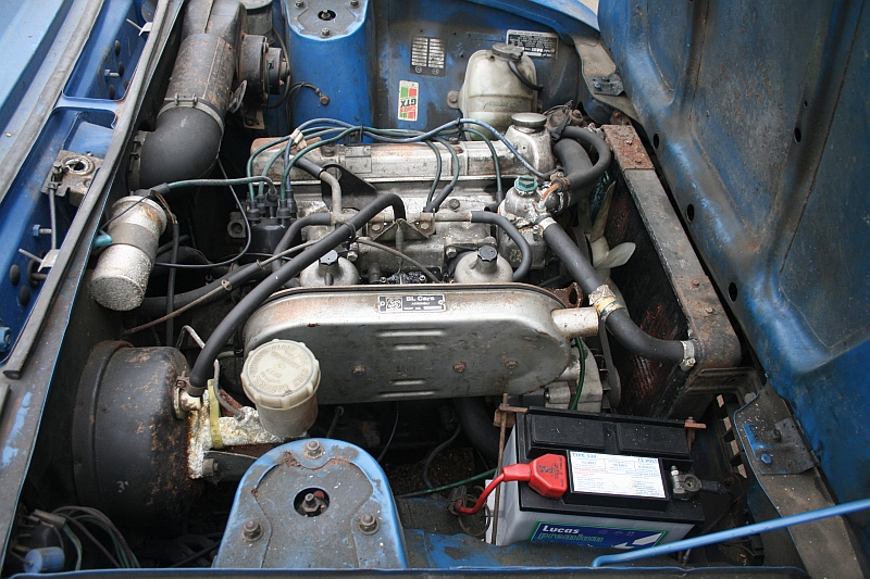

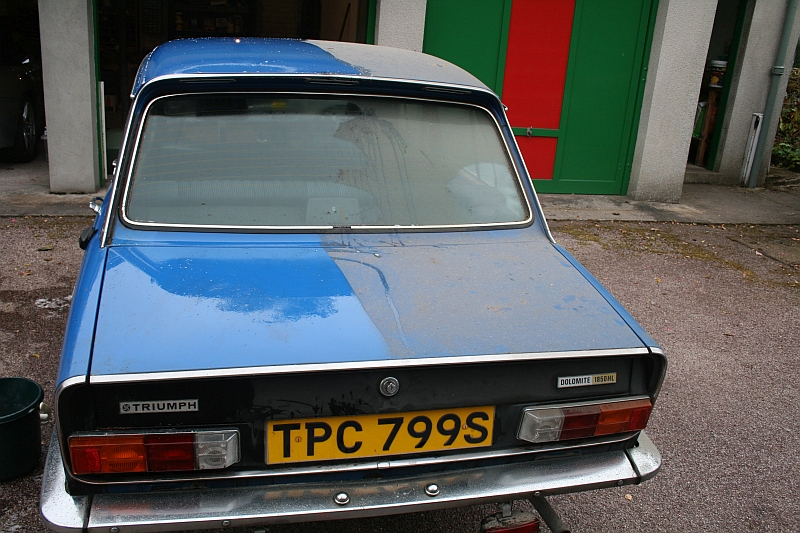

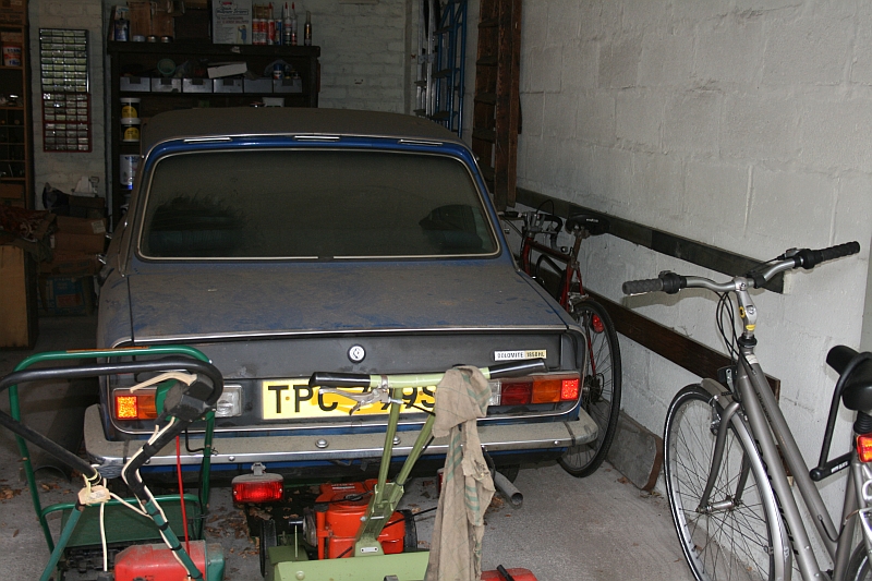

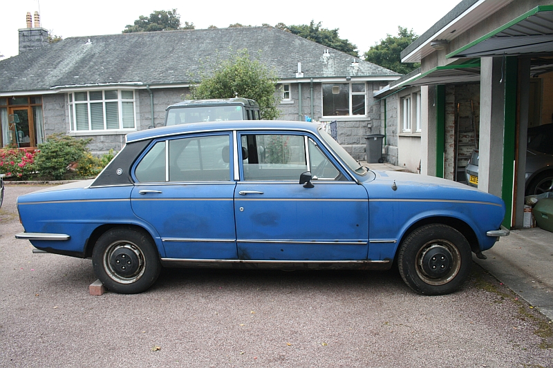

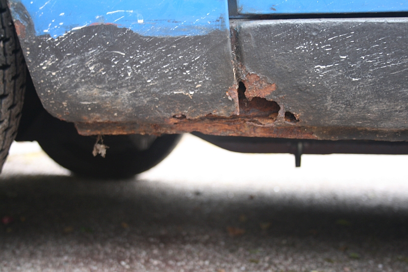

I've been to assess the 1850 HL that is being offered to me for nothing. It is a 1977 car, has covered only about 60,000 miles from new, and has only had two owners, one of whom is my brother-in-law. The car has sat in his dry and dusty garage for 24 years. Once I had freed off the brakes and pushed it outside I could see that the only serious corrosion is in the front of the left sill. It looks as though it needs a lower wing panel and the sill wants patching. Having given it a good knocking the rest of the metal seems perfectly sound. It has never been welded before and there is no filler anywhere. I lifted the carpets and floor and inner sill still shows intact original paint. The underside of the car looks very sound everywhere. The exhaust is new.

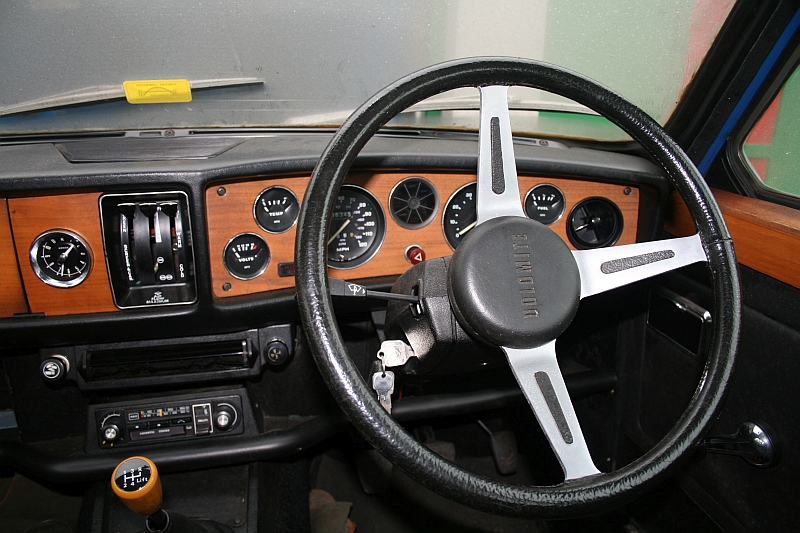

The body generally shows the paint to be incredibly thin and there are small patches of surface rust in several places, so it needs rubbing down and repainting. Which is a pain because the cost of a respray is as much as the car is worth. The interior is perfect and just needs a clean. My brother-in-law tells me that the gearbox (non-overdrive) jumps out of third gear, and the clutch is seized. The brakes need a complete overhaul. The engine ran well the last time it was started and it isn't seized. The diff shows no backlash at all.
The welding and mechanical bits I can do, but I don't know what to do about painting the car. What suggestions do you forum folk think? What would you do? First thing is to move it 180 miles to my house!

Apart from the end of the sill looks pretty solid, very nice.

Why do you think the paint is "incredibly thin"? I would give it a good wash and then a quick wax to see how it looks then.
It could be either pageant or tahiti - hard to tell until its clean...

It's just that all over the car there are tiny rusty speckles as though either the steel wasn't prepared properly before painting or the paint was somehow porous.Why do you think the paint is "incredibly thin"?
The paint code on the chassis plate is 146 which I believe is Tahiti.

The black paint on the sills and rear wing appears to be non-original, so does it hide more rusty areas or filler repairs?
