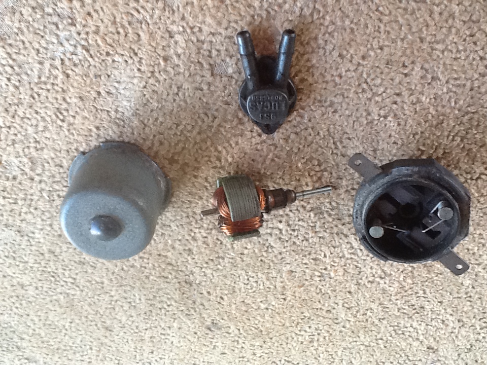

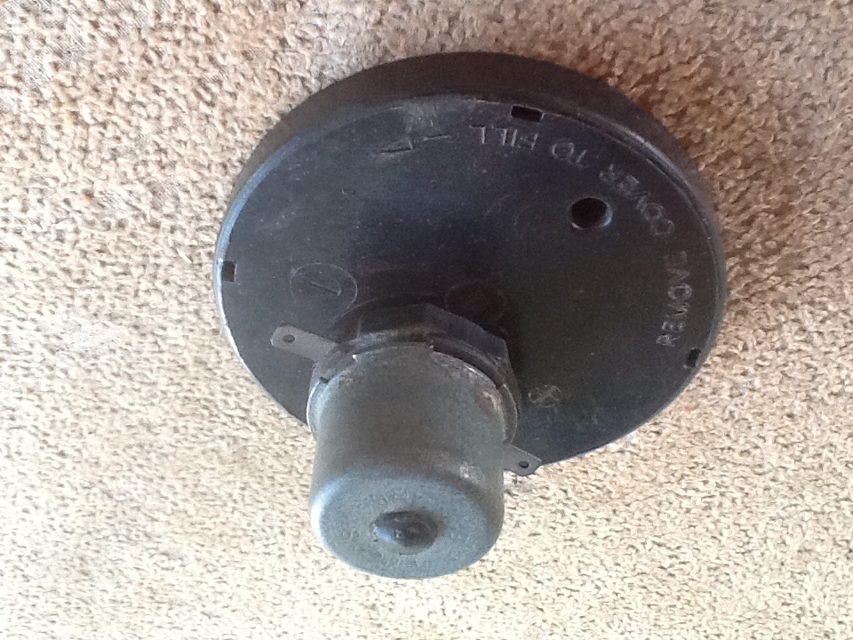

Hi ,
Does anyone know who can rebuild this type of washer pump please
Or does anyone have one .....
Thanks Simon
Thanks Simon

Hi Simon,
We have one as well, it doesn't work. The motor works, but the pump rotor is toast.
How did you get the lid off?
Paul.
Paul.

I just spent the morning reconditioning 3 of the later type.
The rubber impeller needs to seal both sides to stop wet stuff wrecking the motor. They almost all dont, which means an annual clear
out and clean up come MoT time, which is a bind on later sprints with the stupid bracket that has the pump down the side.
They dont suck that well either.
Trico do a much better design that I seem to have one or 2 of from somewhere.
