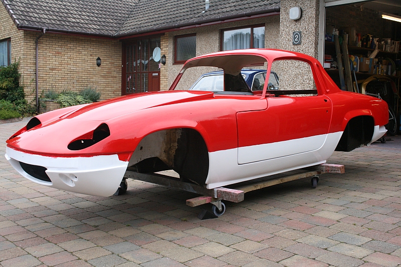

Two or three years ago I repainted a Lotus Elan with brushes using International Perfection yacht paint. This is a two-pack epoxy paint and gives a fabulous shine right out of the tin, but it has to be cut back and polished with a machine after a couple of weeks to lose the brush marks. A lot of work but the final effect was good and those who saw the car couldn't believe I had done it with a brush. See the final result in my photo.
