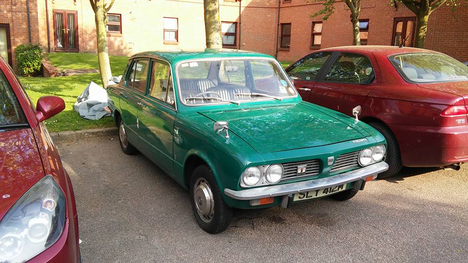

I have a 1500TC (picture attached). It's been off the road for 10 years and has been with a local mechanic who remembers working on the cars back in the day but needs the advice of a Triumph expert for the best path to follow. I'm not mechanically minded so apologies if my description doesn't sound entirely fluent.
He's done a lot of work to the car but has now found that the:
- Crank Thrust washers are worn
- Block and rear main bearing cap is badly worn and needs machining
- Deep scoring on crank shaft (wonders if there is enough metal to regrind)
- Needs re-bore (No. 4 scored).
If anyone has any experience of the above and knows of the best solution, please let me know. I'd be very grateful.
Thanks
Dean

Most of those problems seem pretty par for the course on a 1500 engine. Sounds like a rebuild is on the cards probably with a new crank if the old one is badly scored. All the parts are readily available for this engine and any decent engine shop will be able to carry out the machining. Be careful though as you really do need to make sure that the thrust washers aren't so worn that the crank has gnawed its way into the block thus rendering it scrap.
You really need to take proper measurements to determine what parts are reusable. I dare say you could pick up another engine for rebuild quite cheaply if you need to.

If the block is badly scored and requires a re-bore, I have a 1300 Spitfire block, the bore size is 69.7 as opposed to the 1500 73.7 but this would allow you to bore out to original size and use your existing pistons,
The crankshaft may not be of any use as stroke is 76.0 for the 1300 and 87.5 for the 1500.

You can have various bits of work done to get your engine sorted but quite honestly the cost is not worth the effort on a a 1500.
Its all common to stuff that gets done on TR6's which suffer very similar problems.
Get another engine from a Spit 1500 or Midget 1500 or Dolly 1500...
Quickest and cheapest way.
Good candidate for a major upgrade to TR7 or Sprint power.

I hesitated to suggest the cheapest solution would be a replacement engine Jon, given the costs of machining these days, but he could easily be buying himself the same problems all over again.
It would be good to keep it 1500TC, they seem to be few and far between...
