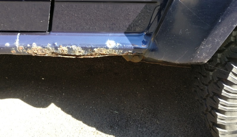

Though the Sprint is fine, the Fourtrak has fallen out with it's outer sills and whilst the body sits on a chassis, it will need fixing for the MOT :-
I've decided that over the years I've handed far too much money to garages to do a bit of welding that it might actually be worth spending the money it would cost on getting my own kit. I haven't actually welded since around 1995 when using a mate's old arc welder I glued on some wings onto a Metro, but as the Fourtrak is quite agricultural, I thought it might be a good starting place to learn! In saying that, one thing that it seems impossible to do is buy repair panels for the Fourtrak, I've seen people replace the sill with box section.
Thinking of buying a GYS SmartMIG, either the 142 at £300 or the 162 at a more hefty £380. A lot of you on the forum seem to be pretty au fait with MIG welding (and I don't mean Tony!), so any guidance would be great.
