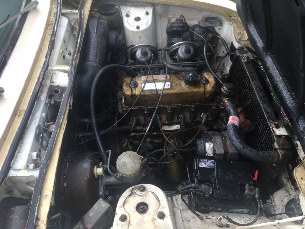

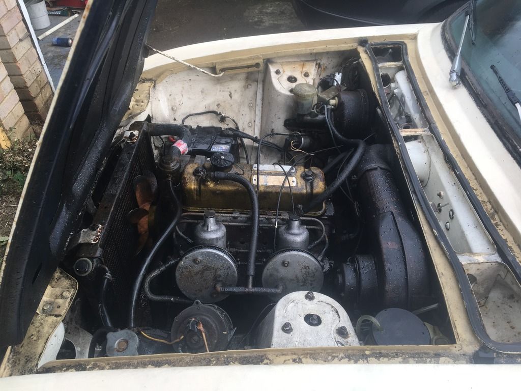

There you go, the B Series 1600 in my dolly, If I take it out and put a zetec in it, it won't be done on fuel injection, it'll be twin webbers like a caterham with a transit gearbox. But as I said, I'm open to suggestions go Triumph, Modern Or leave it modified with its MGA engine

#8 Post by Jon Tilson »
I might be interested in a swap or deal on that...
I have available a reshelled TR7 engine and 1850 subframe that would go well in that dolly. I think I saw it advertised on ebay a while ago in the Aldershot area but wasnt in a position to do anything about it then.
Let me know your thoughts on this in a PM...
Are you sure its an MGA engine? The clue will be where the dipstick is and the shape of the sump. This would go nicely in my Z magnette and the TR7 lump would go well in the dolly, which looks to have been an 1850 by the position of the battery.

#9 Post by Carledo »
I'd keep it as it is - just for the novelty value!
I've seen all manner of engines put in Dolomites and done a couple myself. That one is new to me and I can't quite understand the logic behind it. That 1600 MGA lump only puts out about the same power as an original 1500 Dolly motor (though the crank may last longer)
My suspicion is that it was done a long time ago and as such, deserves to be left alone.
If you do decide to change, an MG man will probably pay good money for a proper MGA engine.
Put it back to a Triumph 1500? well no! you'd probably lower it's value!
And there are better engines than a Zetec to put in, but then my GM bias is well known, but I also think well of the Nissan Turbo (200SX/S13) and both Vauxhall and Nissan motors go in easier than the Zetec.

It would need a front pan sump like a ZA to go in a Dolomite at all, so you might be on a winner there Jonners.
