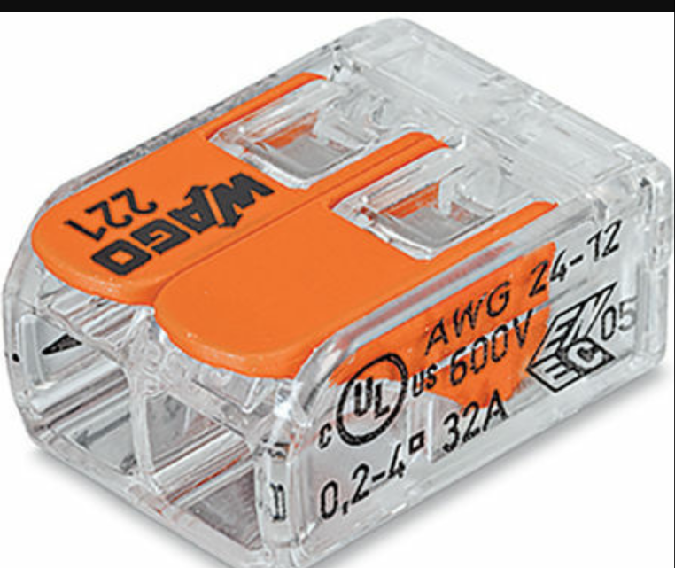

When I had the tunnel out I should have put a couple of these in near reach under the gearstick console.
It would allow a quick and easy change of cable whenever required.
They are reusable and simply clamp the cable to an internal bus bar type of arrangement.
Next time
