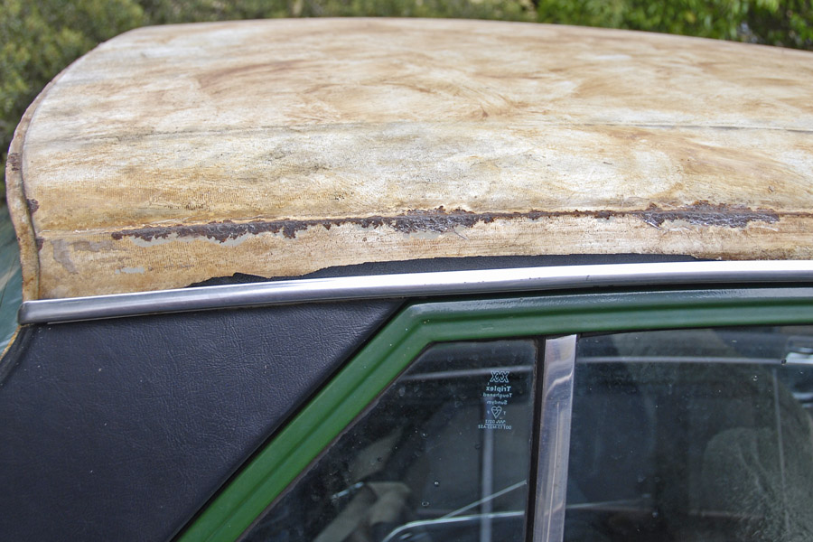

Terry has raised a very interesting point, one which is continuing to cause me a lot of anxiety. I have been debating whether to remove the vinyl roof off my more recently restored Sprint for I have come across several Sprints in this country on which rust has formed under the vinyl on their roofs along the crease line that runs in the roofs above the doors. This is not a part of the country here where we normally get a lot of rain but clearly what is happening is that moisture is being trapped between the underside of the vinyl and the painted surface on the roof.
The photograph shown here is taken from a Sprint which was originally painted white, the colour of the roof you see here, and then repainted later in green, the colour showing on the door frame. As I understand it, the older paint systems used on our cars are porous and the only way of keeping them reasonably waterproof is to apply a polish to the painted (and chromed) surfaces on a regular basis. That of course is impossible under the vinyl covering.
Yes the purists might well cringe if we, in this part of the world, remove our vinyl roof and c pillar coverings and perhaps paint both them black to mimic the original factory specifications but I am personally more interested in preserving our cars. Indeed I wonder about the wisdom of having a black roof which attracts the heat in the summer.
If Terry is keen on replacing the vinyl covering then I would suggest that he investigates using some of the more modern paint undercoating systems for some are considered to be totally waterproof. The system he might use may not be compatible with the paints used on the rest of his car but it would never be seen nor would it stop the vinyl being glued to it.

looking at the vinyl roof with the rusty edge line, this make me think that the roor was not glued correctly and the profile of roof allowed water to sit in the gap causing the corrosion.
Malcolm

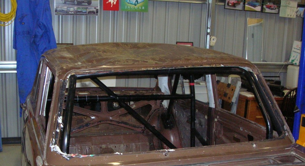

Only vinyl I've ever taken off a car, which was by that time 35 years old, was the rolled race car. Roof was in very good condition but has obviously been well painted in the first place. The vinyl seams looked original and no signs that the car had ever been 'restored' in any way. Given it was registered in NZ in May 1975, it was likely produced late 74 / early 75.
Moral to this is probably that if you prepare and paint it well, then stick the vinyl on thoroughly, it will last as long as the rest of the car. Having said that, I haven't got around to putting a vinyl roof on the replacement bodyshell!
