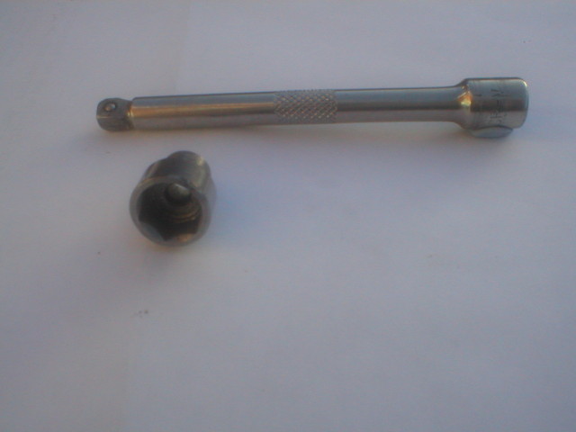

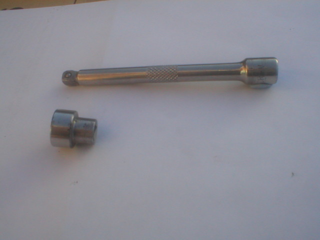

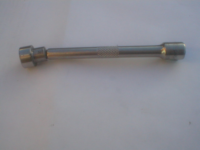

- Posts: 2336
Re: Sprint misfire at lower rpm, especially under load.
This was my solution to Sprint distributor removal. You need to turn down a 1/4in drive socket on hex length ( just long enough to cover the bolt hex ) and on total length then turn down the excess metal around the 1/4 drive square orifice to clear the bulge on the dizzy body. You then use it with a 1/4 drive "wobble bar" to get the ratchet up at an angle somewhere near where you can use it.
I had our machine shop turn up half a dozen of these about 10 years ago and the extras went to Club Spares. They have all probably been sold by now though.
