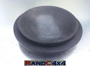

So finally had the chance to have a look at the slave cylinder. Without the propshaft in place it was quite easy to undo the bleed valve. I can imagine that it would be a different story with the prop in place. I decided to cut a hole in the alloy tunnel and fit a 'Land Rover Transmission Tunnel Grommet' - to give it its full title. Its about 3 inches diameter and should be good to undo the slave cylinder bolts in case of need. I will also do a remote bleed valve - just getting the bits together at the moment.

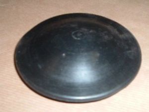

Does it make a difference if the remote bleed valve is higher than the master cylinder as the latter is quite low down?ham204 wrote:So finally had the chance to have a look at the slave cylinder. Without the propshaft in place it was quite easy to undo the bleed valve. I can imagine that it would be a different story with the prop in place. I decided to cut a hole in the alloy tunnel and fit a 'Land Rover Transmission Tunnel Grommet' - to give it its full title. Its about 3 inches diameter and should be good to undo the slave cylinder bolts in case of need. I will also do a remote bleed valve - just getting the bits together at the moment.

On a slightly different tangent I have ordered a vacuum bleeder to do some brake work. I'll be interested to see how I get on as actually it could work very well for the clutch hydraulics. You attach it to an air line and another bit to the bleed nipple and then it sucks fresh fluid through. For the Mazda you can't fit the eezebleed to the cap and I can't always rely on the MK1 Wife to assist with some pedal work. I thought for £20 it was worth a shot.
On whether the remote bleed being high is a problem, I would say no. If you're forcing air out of the reservoir whilst using either your foot or an eezebleed then the position of the bleed nipple is the least of your problems.
