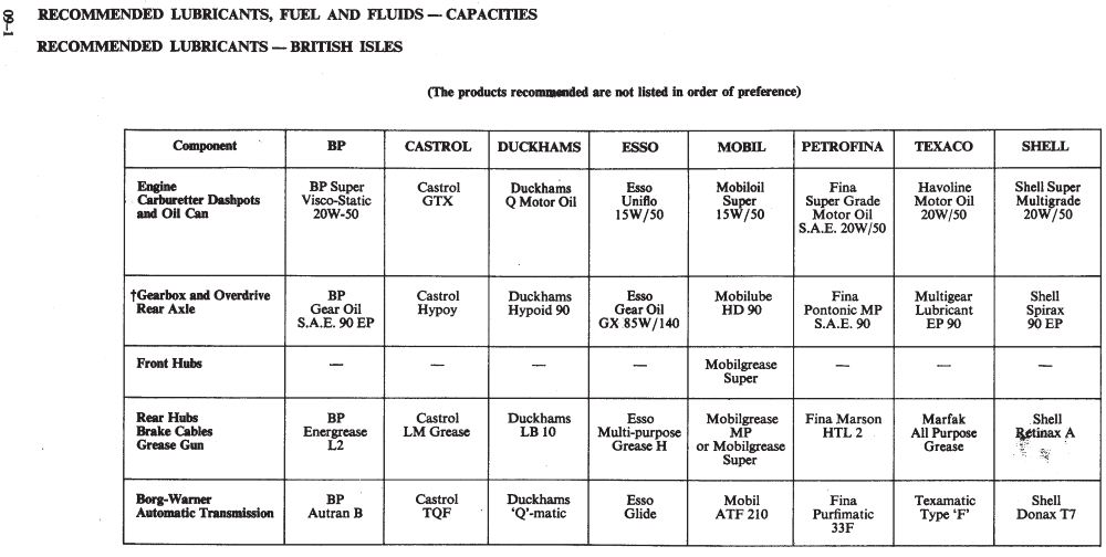

I was topping up the rear diff on my Sprint with GL4 which I use for all my other classics. I was surprised a few days later to read in the owner's handbook that the recommended oil for both the diff and the gearbox is GL5. So......any harm in leaving the GL4 in the diff?

If you look on Page 09-2 of the 1977 Sprint manual for Overseas cars it states GL4 for both diff; and gearbox. For temperatures both above and below 0 Deg C. Did this change for later cars perhaps ?

If you wandered into a branch of Unipart and asked for EP90 in the 70s you would have got GL4. Oh, and GL5 contains phosphorus and sulphur compounds that will turn your gearbox into an attractive garden ornament.
- oil.png (125.05 KiB) Viewed 1681 times
