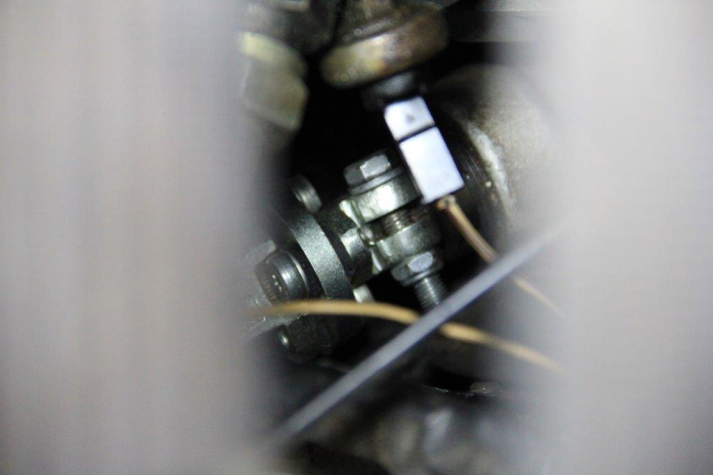

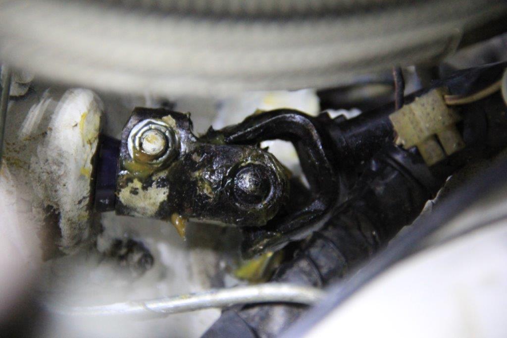

In terms of flexible couplings etc the other job I recently did was to replace the collapsed lower steering column bush. In doing that I've refitted the couplings - see hard to take photos below :-). The top coupling is UJ and pretty sure I was going to fit lower UJ one as well until I found the two parts wouldn't fit properly in the available space. I think the spline was too long I can't remember. Bless Rimmers.
So it does have the rubber bits but I don't think they are too shot. See, as best you can, in photos.

#7 Post by Robert 352 »
That is some clever photography there being able to get that bottom universal into focus as you have done. I replaced those rubber bushes with some old stock I had and they lasted only a few months before I replaced them with something a bit harder and purchased, in my case, from the local Lotus dealer who is up in Auckland.
I discovered that the problems that I had were all in that upper universal joint. I fitted one from Rimmers, it took a wee bit of work to get it to fit nicely. I ran a wire buff longitudinally up and down the splines until the bottom universal was free to slide up and down easily. I had a small problem with the universal binding at an acute angle but Rimmers seem to bend over backwards to service those of us who live far away. It is never an issue that cannot be resolved for they will happily replace at the drop of a hat.
My suggestion would be to try and fit that replacement upper steering shaft for if there is any play whatsoever in the upper universal it will be magnified when you are driving on the road. I was getting a lot of vibration fed back up through the steering column for we still, in this part of the world, have gravel surfaced roads which develop ruts and corrugations all the time.
Keep at it and don’t give up. Remember it is a British car and we now have the knowledge and expertise to sort these issues out.

Thanks. Nothing too clever - just an SLR zoom pointed through the gap and manually focussed while the subject was lit by a portable worklight !
My car has the upper shaft with the UJ and was going to have the lower rubber-grommet-flexi-coupling replaced with the lower UJ coupling that Rimmers do. When I went to fit them together they wouldn't because the spline on the upper shaft was too long so I refitted the old part.
I seriously doubt the upper shaft has any wear since the car has had little use since it was fitted but I will check it I think. The question then is whether the new upper shaft parts have a shorter spline in which case one answer would be to order one and then use both parts. Alternatively - thinking about it - there's nothing to stop me cutting a bit off the splined end of the current one.
I really doubt the steering play is resulting from these couplings although it is possible the flexi lower coupling isn't helping. It's a course of investigation. I just suspect it's play in the rack plus some weird suspension geometry problem per other threads.

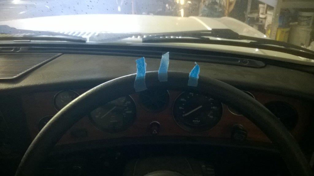

1. Floaty steering.
Can you measure in inches the actual amount of free-play you have at the steering wheel rim before any wheel movement. ( With the wheels on solid ground ) please.
Are the tyre pressures O.K. just looking at basic stuff ? Over inflated tyres give exactly that effect. Even one over-inflated tyre will.
Then when all the play in the steering has been eliminated I'd go for complete 4 wheel alignment with castor and camber. About £50 here in the U.K.
For instance If the front wheels are toeing out it gives very strange steering characteristics. Has there been any rear-end damage so the rear axle is bent ?

Hi M.Wielder - I just tried this with my son moving the steering wheel while I monitored the hubs. It was on stands with wheels off so not exactly what you suggested below but we double-checked it a couple of times and it also reconfirmed when viewing the hub and operating the wheel with one hand.
The variance was as shown in photo below. Do you think there would appear to be more slack if the wheel was under load? I'm not sure I see that - either the play is taken up (and the hub/wheel moves) or it isn't.
Side issue - how do you get photos to insert in the text. Mine tack on the end only. The "Place inline" button does nothing.
Anyway, so there's the slack. Not much more than 10 degrees if that I would have thought.
No rear end damage that I know of. Rear bushes OK I believe, gave them a once over before so think they are OK. Tyres OK.
I think the car had a front corner accident before I owned. Fairly sure I remember being told that but looked OK and since rebuilt with new front wings and numerous related bits anyway. There are some historical weirdnesses :

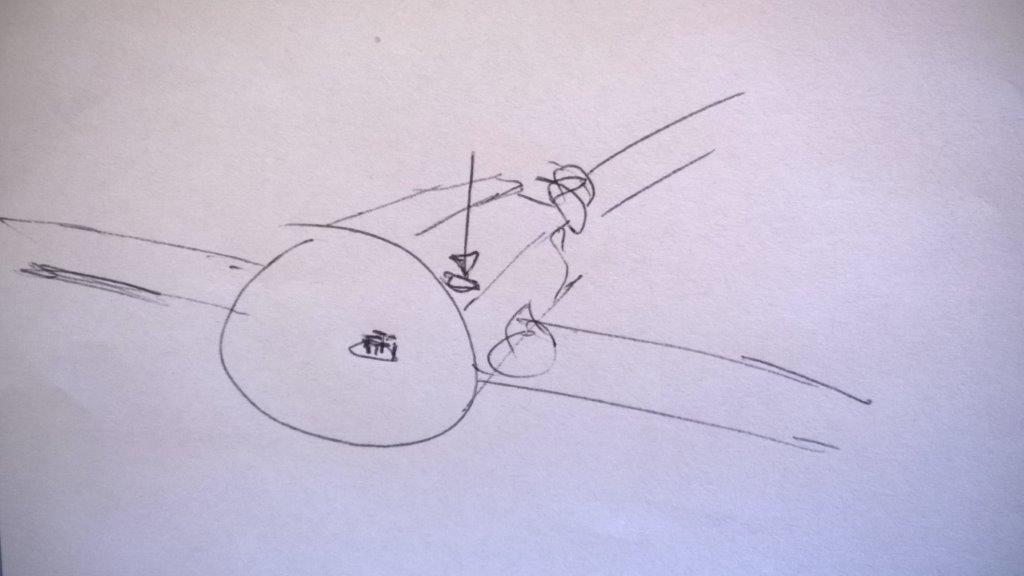

I've been trying to locate the breather without confirmed luck
See 3rd grade sketch below. So we're, ahem, looking from the back of the car on this masterpiece and the doodle in the circle represents the filler plug.
On the actual diff casing - not the rear cover - there is something sitting vertically at the spot marked by the arrow that feels like it might be the breather. I couldn't sight it at the moment due to the front of the car being jacked up!
Anyway is that the location of the breather? Whatever it is that is sitting there is not a loose cotter pin but some kind of rigid vertical "thing" maybe 1cm tall.
What is this breather like on a Sprint - the cotter pin of the TR6 or actually this : http://www.rimmerbros.co.uk/Item--i-21H6060.
It does feel like the latter. How would you even tell whether it's blocked though ??
thks
