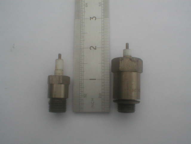

Re: Colortune for sprint
There are 2 versions of Colourtune around.
The large original one was supplied until about 1990 when the smaller version appeared and was advertised as being " Now suitable for the Dolomite Sprint and Vauxhall Firenza " I think it was.
I imagine Alan has the larger one.
- colourtunes.jpg (17.34 KiB) Viewed 1305 times
