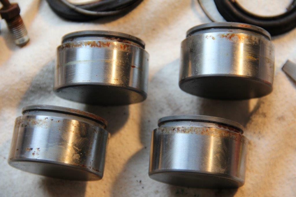

I just managed to removed the old seized pistons through a combination of hydraulic pressure followed by slowly drifting them out by tapping around their rims.
The pistons are history anyway. The intent is to get stainless ones.

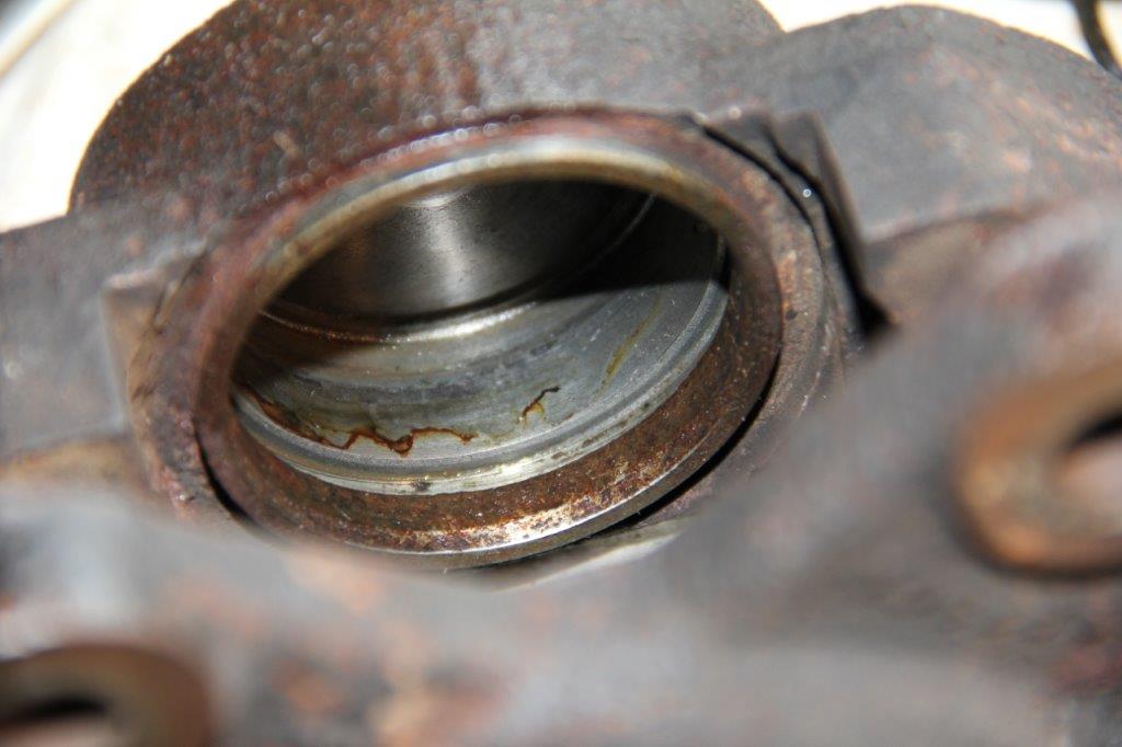

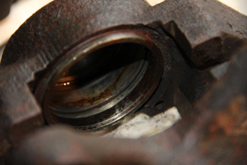

My question concerns the calipers themselves. While the pistons have surface corrosion the calipers also have a rusty residue within the piston recesses. See photos below.
Is that a problem? Is it recoverable/removable and if so by what method? What are the calipers made of anyway? Is this rusty residue a parting gift from the pistons or actual corrosion of the calipers therefore?

when ever I have stripped down a pair of brake callipers, I have a put them in a bucket of vinegar.
Every couple of days give them a brush with a small brass wire brush to remove the excess, then soak for another day and repeat.
Use in a well ventilated area as the gas this process gives off can make you feel unwell.
They come out like new, also to be sure to clean the groove where the square section fits, re-assemble with with red brake grease.

Well they definitely need a refurb, you'll need new pistons and a seal kit. Let's assume that the bores on the actual callipers are OK then you could easily do the work yourself. If the bore are not so good then a specialist might be required. Perhaps give them a lick of paint at the same time?

I have cleaned up worse pistons than that and resealed with no problems, reuse them after a good clean up and new seals

The vinegar will not affect the bridge seal in the calliper either, it is only 5% acidic not like sulphuric acid, the vinegar removes the rust that you can not get too and does not remove the base metal.

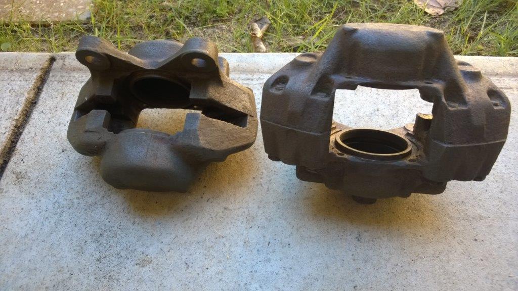

Ok well they are in the vinegar brewing up.

If the pistons are too badly corroded then replacement is the only solution.

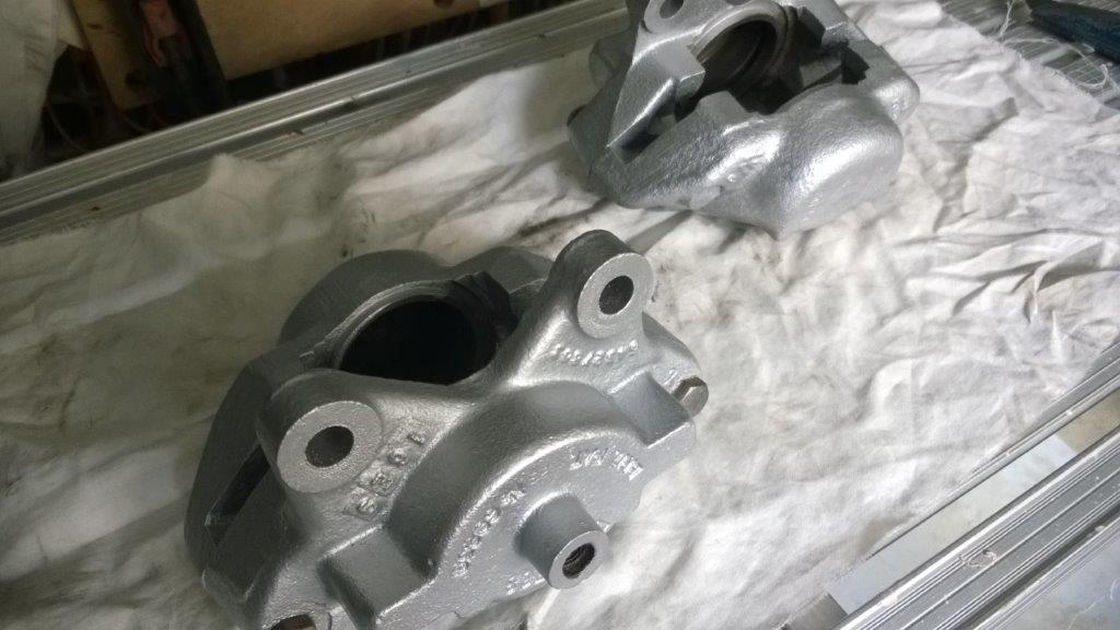

Here's a couple of pics showing the calipers after they'd had a 3 day vinegar etch and then today, after a top coat with Dupli Color caliper paint.

Wow, they've come up really well. Did the pistons clean up OK or are you still going to fit new ones?
