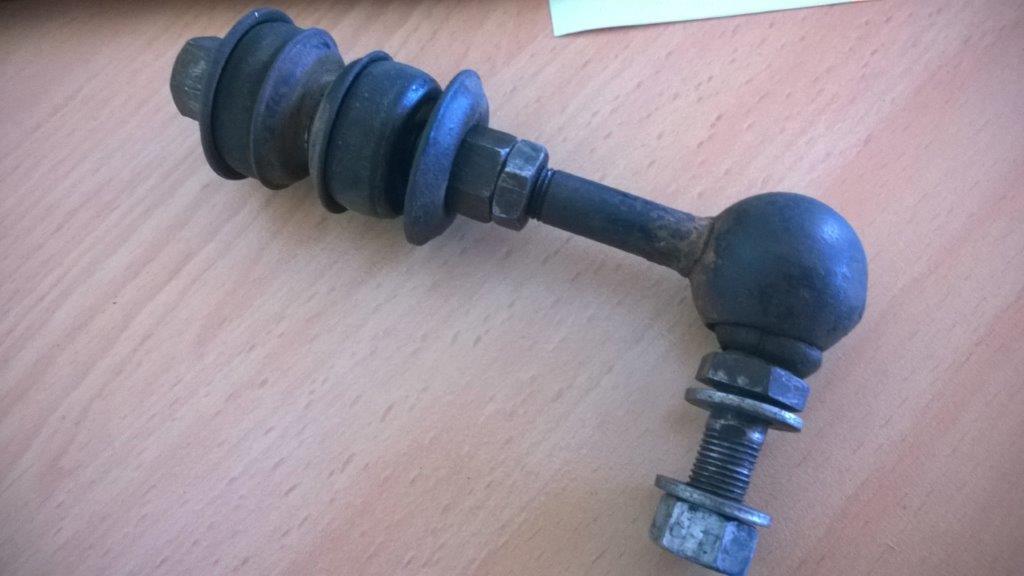

Guys
Here is your picture of the said bush:
Paul
olr159w
Posts: 362
Joined: Sun Sep 20, 2009 4:27 pm
Location: Perth, Australia
Re: Sprint engine stabiliser bar - assy and wear and tear?
#15 Post by olr159w »
And here's a picture of mine.
It seems to be in fair shape so I'll stick with the plan to only change the two bushes at the bodywork end
