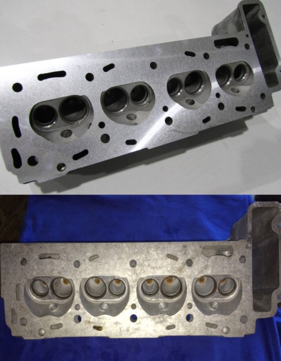

* In the 2nd photo what are the 2 extra tapped holes for above cylinders 3 & 4 please ?
Edit > Answer 14/4/17 : The version of the Dolomite head with those 2 extra tapped holes comes from a Saab 900. Thanks to Jeroen for that.

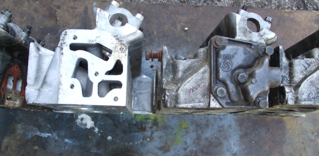

* In the 1st photo it looks as if the top right tapped hole for the rear-of-head-plate has got a tapped insert in it . Rather like a helicoil, only larger. What is this called please ?

in picture one, that looks like a time sert

Hi Dave, Thanks very much for that. I hadn't heard of this system before.
It looks like an alternative to the Helicoil thread system readily available in the U.K,

I can see a positive advantage where the thread is in water or oil as it seems to seal nicely.

I thought time sert too but Ive not seen one with the 2 cuts in the head of it before.
Re: Two more 1850 head questions.
A saab 99 head. The insert is a plug that plugs the oil bore.

To clarify, is this is a SAAB head because of the 2 extra tapped holes, or is this version of the head casting shared with a Saab 900?MIG Wielder wrote:Edit > Answer 14/4/17 : The version of the Dolomite head with those 2 extra tapped holes comes from a Saab 900. Thanks to Jeroen for that.
These holes are used at a saab to hold a defroster hose from the exhaust manifold to the airfilter box. Saab had this engine fitted some years before they were fitted to 1850's. I'm not sure of the very early 1850's if they shared the casting. The 1850's I had never had these holes and the oldest I had was a 1973 one.

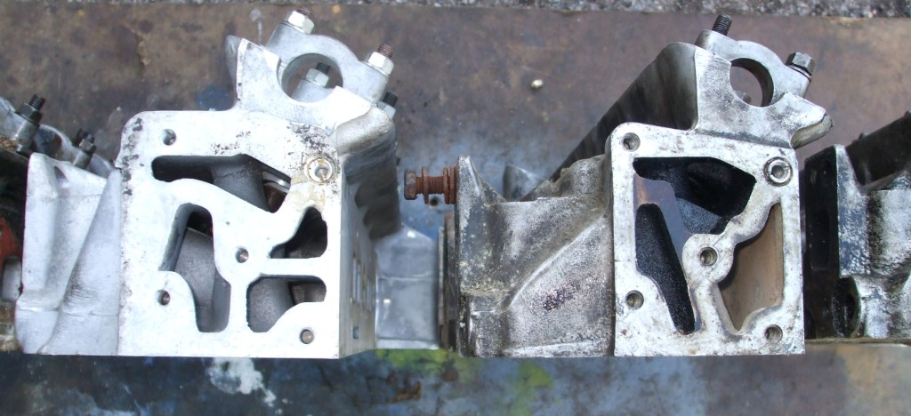

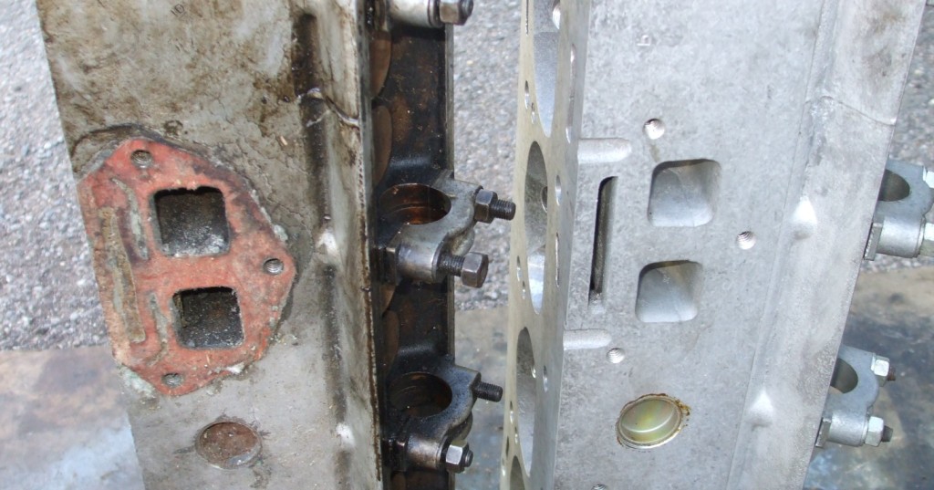

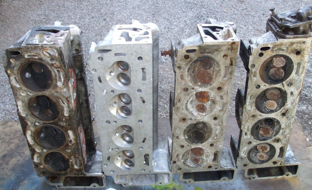

Following on from the comments above about 1850 / Saab cylinder heads I decided to inspect the cylinder heads I have, as I have not previously noted any differences. As a result of this investigation I have identified that I have two types, three (including the one on my car) with the 2 additional threads to hold the Saab defroster hose (which I will call type 1) & two without (which I will call type 2).
Comparing the two types I have noted the following:
Type 1 has the above mentioned additional tappings, type 2 have small additional untapped lugs just above the exhaust ports.
Type 1 has a different profile to the rear of the head (to the left of the water transfer mountings in the photos below) and a different water transfer housing (type 1 up to 76 water transfer housing, type 2, 76 on water transfer housing).
Type 1 and 2 have differing oil / water galleries on the back of the head necessitating the different water transfer housings.
Type 1 has an addition slot under the inlet ports for cylinders 3 & 4.
Types 1 and 2 have a slightly different profile to the rear most water gallery on the face of the head.
I have not measured the valves so I do not know if these differ also.

The one with the lugs above the exhaust ports are for the egr on a tr7. I cannot see the chambers that well on my phone but the tr7 has a bigger chamber and I thought only tr7 heads have these lugs in their casting. I'm not sure if your type 1 and 2 are pre 1976. Maybe the stromberg versions. Saab didn't use these head's from 1972 on. Maybe that is the revision date.
Just checked. My 1850 head has also egr lugs.
