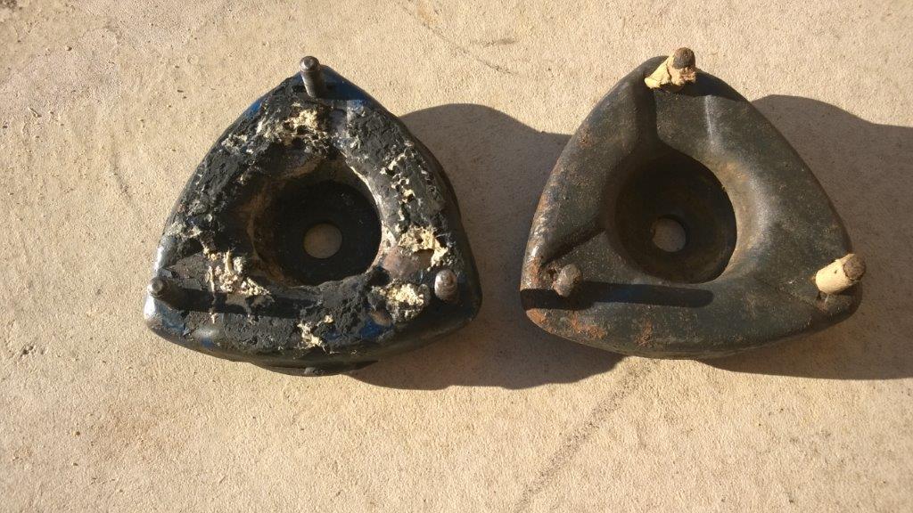

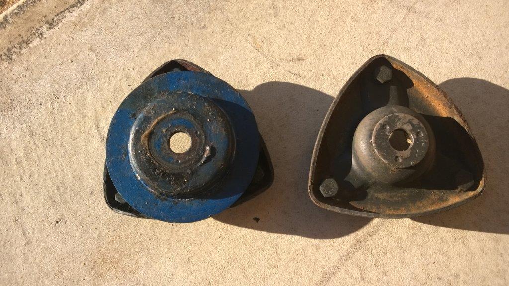

I got stuck into replacing the front shock assemblies after other work and this included replacing one of the top plates that has a crossed thread on one of its turret mounting bolts.
See pics of new and old below. Bless Rimmers once again because once again they have supplied the wrong part.
The replacement part was described as :
Front Spring Upper Mounting Plate - Sprint/1850 - New Old Stock 157333
But in fact it is missing a lower plate (presumably to fit larger springs) and I suspect is therefore most likely a 1300/1500 part. Its extra aggravating when this happens overseas because you have to wait another 2w for the part to show up even assuming one is available.
In case one isn't available from RB does anyone know of a source? I think someone mentioned having spares in a previous thread; I'll have a search for that as well.
thks

Can you not swap the lower plates over?
If it was me, I would have replaced the bolt in the original.
Re: Sprint front shock top plates
The lower plates are welded on at 3 pts around circumference plus almost def spot welded 3 times in the centre.
You can't get the bolts out since a) they are tacked in place and b) fouled in terms of replacement by the position of the circular plate.
It seemed a good idea to oder the part while I was getting other stuff, job theoretically done. Except not.

No, Rimmers are using the Sprint/1850 part number for a 1500/1300 part. The part they've sent out is 142777.

That is exactly what I assumed is the case. Oddly the RB site indicates 1300/1500 part is unavailable and only 1850/Sprint available as NOS.xvivalve wrote:No, Rimmers are using the Sprint/1850 part number for a 1500/1300 part. The part they've sent out is 142777.

Is it possible to run a 5/16"UNF die down the offending bolt?olr159w wrote:So alternatives?
This might salvage the thread, it sometimes works.

It takes 5 minutes to grind and drill the plate off. It takes another 2 minutes to have the welded centrepiece off the new one. Then 3 minutes to weld the plate on the new one. Then 1 minute to grind/flatten the 3 welds in the middle.
