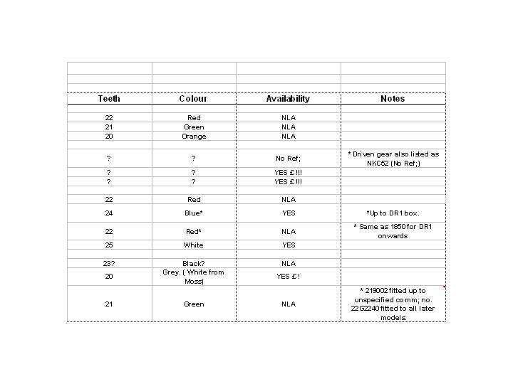

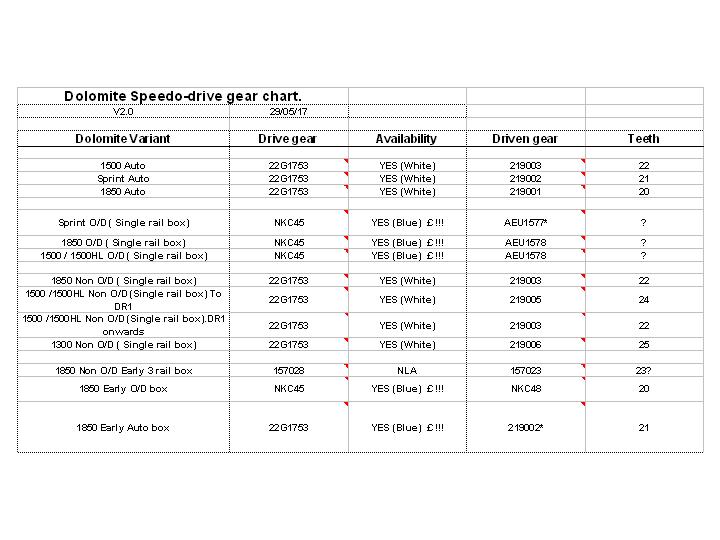

- Posts: 2336
Re: Sprint auto speedo
Here is a comparison I did earlier ...
( 2 files JPEG from .xls so left and right halves of the file )
HTH,
HTH,
- Dolly speedo 1.jpg (60.42 KiB) Viewed 1734 times
- Dolly speedo 2.jpg (35.41 KiB) Viewed 1734 times

Looking at that, then, the green gear is correct for sprint auto? Where the red came from ???????????
