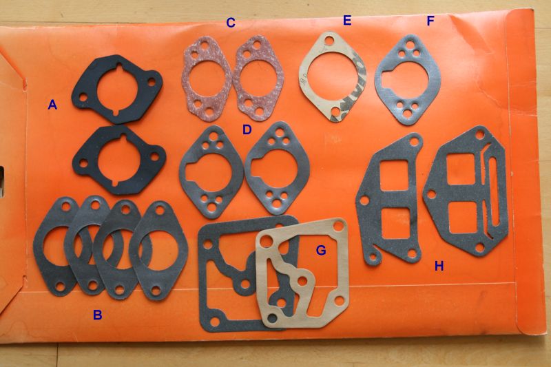

I bought a NOS head gasket set from a TDC member recently. It is marked Tecaseal TCK 270. Some of the gaskets are obvious, but some are not to me, a Dolomite novice. Can someone help please.
G are the two different types for the rear transfer housing.
H are the exhaust manifold gaskets.
But what are the others? Gaskets A are made of a thickish rubbery stuff.
Thanks.
Oops, just noticed that D and F are three gaskets all the same! :oops:

A - For Strombergs, goes between the carb and head
B - SU Carb gaskets between carb, rubber mounting and head
C - SU Air box to carb gasket
D - Stromberg Air box to carb gasket
E - Thermostat housing
F - As D
G - plate on the rear of the head, one for early plates and one for late
H - Inlet Manifold to head gasket. You need to check the thickness of these, some of the newer gasket sets have them too thick and the O ring in the inlet manifold doesn't seal properly.

Brilliant :lol: Your degree certificate is in the post. The rubbery ones at A had me puzzled, but that's because my car has SU carbs. So now I know. Thanks.
