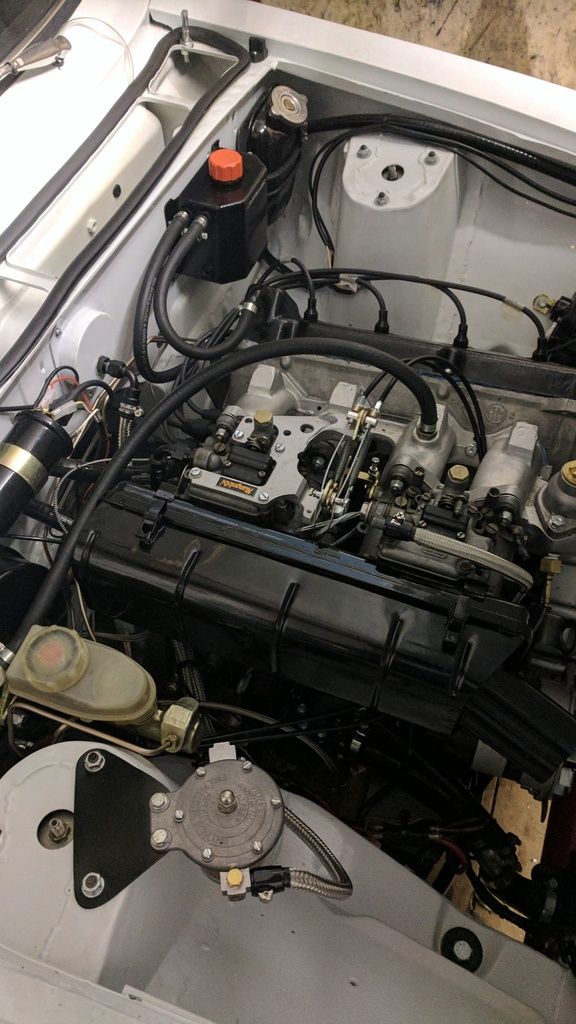

The filter regulator you can use is a filterking. You can set the pressure with a pressure gauge to 0,3 bar. Then you have a simple bulletproof setup for your carbs.

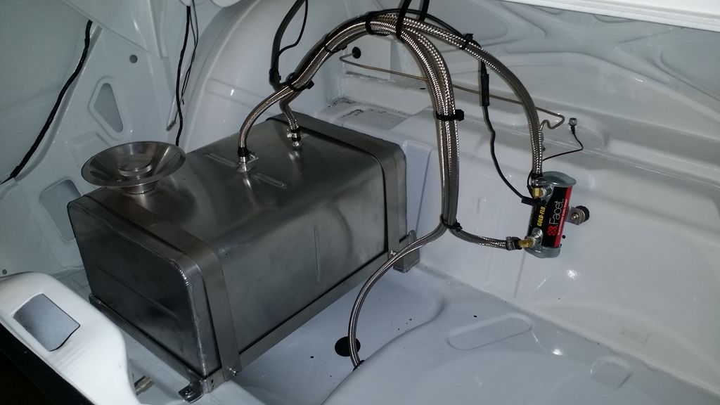

I'm using Weber 45s producing about 170-180 BHP at the flywheel. I used one of these Facet solid state pumps which does fine for the odd track day:-
https://www.merlinmotorsport.co.uk/p/fa ... -fac-ss500
Webers/Dellortos only need about 3psi.
Mounting is not pretty but it's up out of the way, only slightly above the tank...it's worked for the last 10+ years.

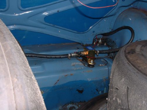

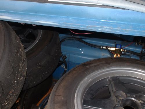

The facet pumps are push types. They need to be at the same height or lower than the fuel tank. Also they need to be fitted in vertical position. In a lot of rally cars you see them fitted lying but then they don't work ok. A facet on the innerwing in the engine bay is a far from ideal position. The best is in the rear axle area. You can easily fit it in between the line and don't have the pump in the boot.

I'm using twin 45 Dell'ortos with a facet gold top pump in conjunction with a Malpassi Filter King mounted thus.....

Re: Fuel regulator
Yes external. No vapours etc. The Facets do have an inbuild filter in the underside so no petrol in the boot while cleaning.
