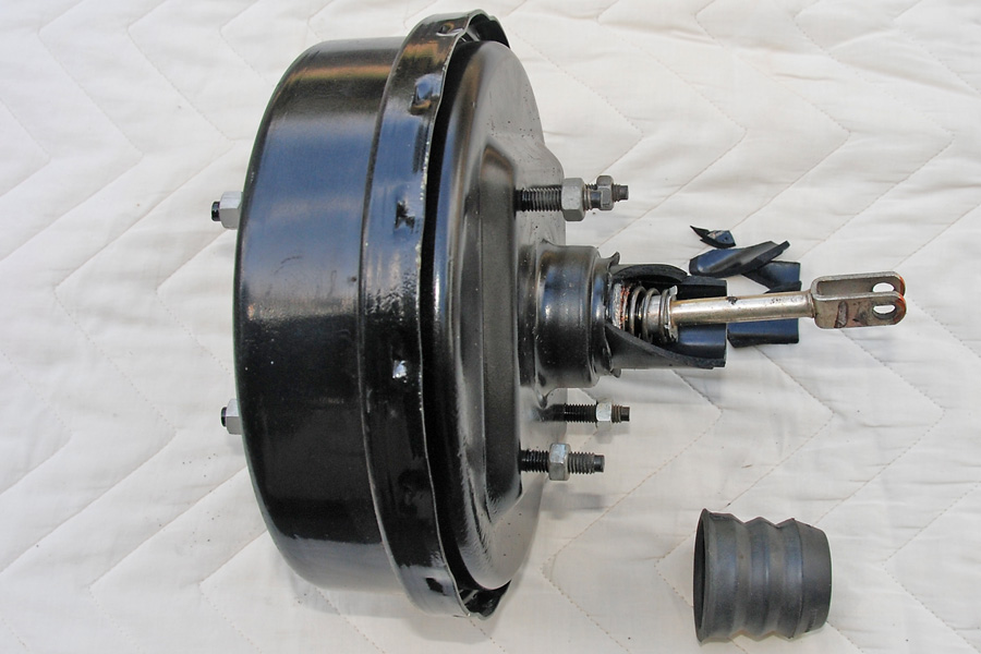

I know that I have a broken bakelite bit in my servo.
I also know that servos do not bounce very well when they are toppled off a shelf in an earthquake. I also know that insurance companies (in this part of the world) do not cover the loss of car parts in the even of a calamity of some sort.
What I do not know is what difference it would make to have this bigger servo refitted in my Sprint than the smaller 1850 servo which I is fitted in the car at this time.
The car seems to stop quite well.......

- 20110205-1130Pw Sprint brake servo damage.jpg (161.72 KiB) Viewed 3455 times
Re: Good news for sprint servos
I presume the bakelite part is internal? Anyone got a pic of one? Im wondering if they can be accessed easily and made with billet aly?

Oh, that's the bakelite bit! Never taken one apart, and thought that bit was metal like Mahesh!Robert 352 wrote: ↑Sun Jul 02, 2017 10:37 pm I know that I have a broken bakelite bit in my servo.
Robert

The broken bakelite in Roberts case doesnt affect operation does it?

I ran my race car using an 1850 servo for years after the original broke and looked identical to Robert's. I was able subsequently to buy a rebuilt one from a guy in Wellington and fitted that. To be honest I never really noticed any difference.
I later threw the broken one away. Just goes to prove you should never throw any parts away, I never learn as I've said that so many times in my life!
