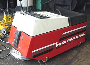

When I did my trackerjack conversion, the original hub was out of true after clocking the disc bolted up to the car. The disc (vw) was flat and true and I ended up filing the back of the hub where it mates with the disc to get runout less than 2 thou. When I worked in a BL dealership years ago we balanced most wheels on the car to take into account everything that rotated together. The machine looked like K9 off Dr Who and you sat astride it

Vauxhall used to specify on the car balancing as well, remember seeing the machine at Shaw and Kilburn about blurbal years ago. Did it say 'Affirmative mistress' when the wheel was balanced right?!
- Hoffman on car finish balancer.JPG (30.4 KiB) Viewed 1506 times
