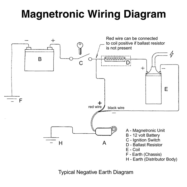

Found this diagram hopefully makes it clearer. I think what the guys are saying is cleared up by the one paragraph at the top.
- 030_340.jpg (82.89 KiB) Viewed 1864 times

Re: Misfire Again
Yes, that is clear enough, thanks.
I'll try it out and see if it helps.
I don't actually know if my wire is ballasted or not ( I suppose it is) - so there is no damage if I wire it the same as above in that case?

Re: Misfire Again
Take a wire from the ignition fed fuse at the fuse box and the unfused (white ) side. This is very important as if your fuse blows your
ignition will also cut out - could be dangerous.
Join this to the red feed on your lumenition and keep away from the coil plus, which if standard will be ballasted.
Lumenitions run for a while on a ballasted feed, but then start to give your sort of trouble.
I would also say the CO is too low and should be in the 5 - 6 % range so this is also contributing.
Re: Misfire Again
My comments below:
Take a wire from the ignition fed fuse at the fuse box and the unfused (white ) side. - So two wires then, one from the unfused and the other from the fused right?
Join this to the red feed on your lumenition and keep away from the coil plus, which if standard will be ballasted. - this is the part I cannot understand - so the coil will finish up with the black lead from the dizzy and the red terminal will remain unconnected except for the lead coming from the dash?
I would also say the CO is too low and should be in the 5 - 6 % range so this is also contributing. - this will be fixed. I had the equivalent of your MOT here and the tester is never happy with anything above 4%
