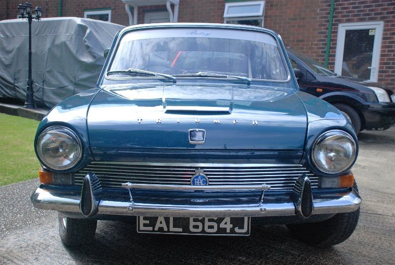

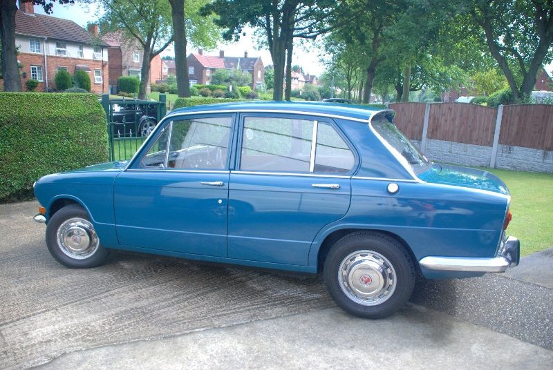

I hope this isn't going to turn into a Restoration Project, but I thought I should start a thread about my recent purchase, as it needs a few things doing to it. Rather than putting various requests for advice on the Forum I thought I would keep everything together here.
I bought the car on eBay on 16th June. A two-owner car with 87,000 on the clock. The previous owner had bought the car in 2008 and he had it painted about a year ago to use at his son's wedding. Apparently it was rust-free before the repaint, but I was later told that rust had broken through on the front of the bonnet and rear passenger-side door. The car has apparently never been welded.

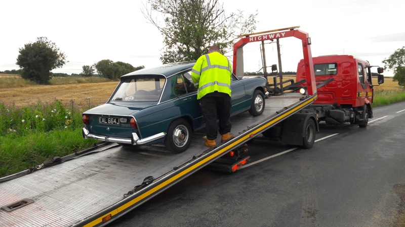

Anyway, the journey home didn't go as expected. 62 miles into the journey the car spluttered to a stop. I suspected a lack of fuel, but the recovery company didn't want to investigate and loaded the car onto a breakdown truck.
At least that saved some wear and tear on the car, but it did take a lot longer to get home than expected.
The following day after fiddling about with it for a bit, I blew back down the fuel line and the car then started and ran fine. I will need to investigate that one further over the winter.
