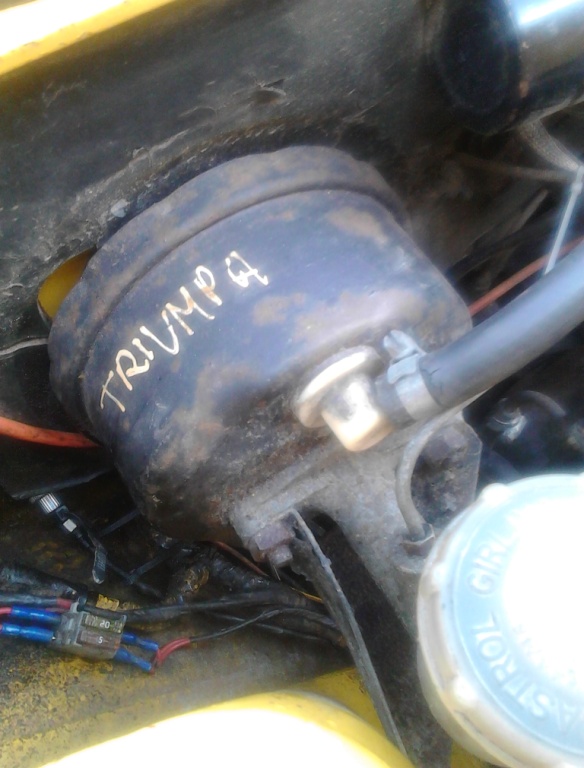

So, somehow I've been unfortunate to have three servos where the pushrods seem seized. The first unit I put on the car the pedal was stuck solid and with a heavy push it cracked, results see photo!
The second unit I put on is the cars original unit, which was in perfect working order when removed, but was just rusty. So I fitted this one and again the pedal is stuck solid. I've removed the unit, and found if you push down on the servo against the push rod it's solid, but if you tilt the servo the pushrod moves in/out perfectly.
If I place back on the car with the fixing nuts on a couple of turns again the pedal is solid, but if angled slightly it moves fine.
Any ideas why this should jam?

I'm running what I think is a 1500 one, but I could have been misled and it's 1850. Whatever it it, it's quite a bit smaller than the Sprint one. Fitted it while the Sprint one went to be reconditioned, and haven't felt the need to swap back.
If the question is whether it's adequate, the answer is it’s fine. I haven't got it to lock the wheels on a clean dry surface, but it stops well enough both town and motorway.

Having run both Sprint and 1850 servos on the Carledo, I can confirm that the 1850 one is a perfrectly acceptable substitute on a Sprint, the performance difference is somewhere between negligible and undetectable, even with trackerjack brakes and a lead welly!
Oh and Graham, that's a 1500 one you have fitted!
