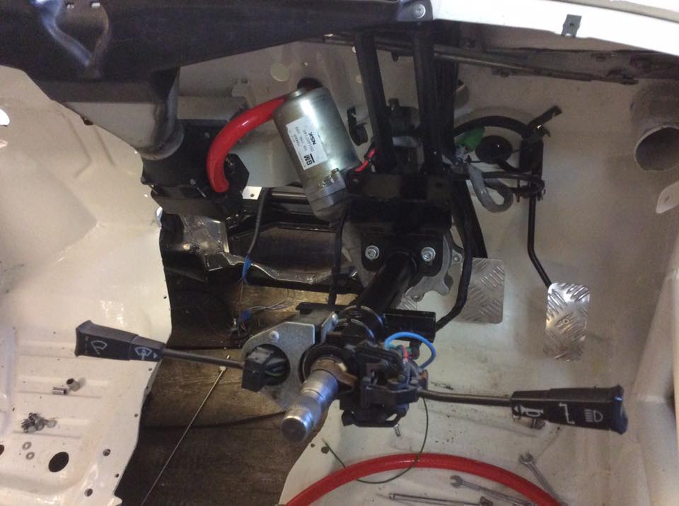

Here is picture of the installation on my Sprint. Based on Corsa B.
- KPD steering.jpg (62.31 KiB) Viewed 3153 times

I have recently collected my Sprint from EZ Power Steering in Dawlish after having their system fitted. It was well worth the cost. The system is speed sensitive and also allows you to "dial it out" whilst on the open road but once you are driving round town or parking bring it back in and a five year old could turn the wheel even when stationary.
It is a very well engineered installation and can be reverted back to standard if you have a purist interested in your car.
Mike Waters at EZ is an enthusiast and a mine of information. Would thoroughly recommend them.
Re: Power Steering Sprint
Nice. Did they fit a speed sensor to the prop flange or somewhere else?
