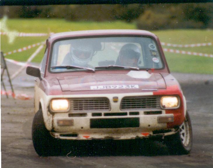

I did this to the car that Dolly-Nut uses for track days - it was my rally car in the early 2000s.
Absolutely agree with all the above. It's a very straightforward conversion; everything you need to fit it, are straight off the donor Dolomite Sprint.
Small points to add:
You MAY have to drill out the mounting points at the back of the gearbox space, for the small GB cross-member. Might be worth plating the mounting points too if you plan anything serious with the car such as rallying.
The curved fascia requires new brackets made/attached to the scuttle at the bottom of the windscreen, the mounting points for the Toledo flat fascia don't align.
You will also want to transfer the Dolomite steering column as well as the heater controls and so on; the Dolomite column will (a.) align properly to the mounts on the fascia, and (b.) carry the switchgear for lights, wipers etc. You will probably also want the 2-speed wiper motor.
Dolomite front loom is pretty much essential - if you can't transfer it from the donor, you will need to make up a comprehensive replica
BL ST of course never homologated the 2-door Toledo Sprint, though one Ian "Del" Lines of Atlantic Garage in Weston Super Mare built his own *at the time*, which can provide historic provenance for a "replica" to make it legitimate for current historic racing/rallying. He at the last count was still alive and kicking, though I believe he lives in Spain these days. He was until recently still involved with the Rover SD1 owners' club.

Re: Converting a 2 door Toledo to take Sprint mechanicals etc
PS memory says 350lb/in at the front, 275/225 lb/in dual rate at the back.
But it was quite tail-happy, particularly so once I got the Detroit Locker diff in it
The Trolley was certainly quite skittish, but LOTS of fun to drive. In hindsight the suspension (I had those springs custom made by one of the coil spring manufacturers in Sheffield) could have usefully been a bit softer, but it was built as a tarmac rally car** rather than for forestry or road use.Carledo wrote: ↑Sun Oct 22, 2017 9:32 pm
