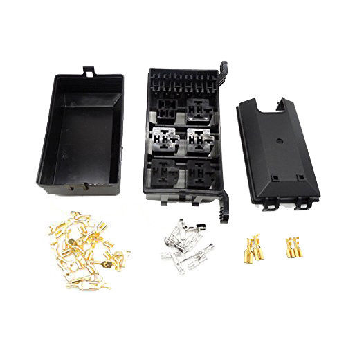

There are a number of relay holder boxes nacelles that take 5 relays as plug-ins and some blade fuses under a lid on ebay for £6-7 (only from China it seems). Look interesting, but not sure where one might fit.

Graham, if it's not too large, a fuse/relay box like that might fit on the N/S inner wing above the battery, perhaps? I found enough room there for a couple of individual relays on the previous Dolomite rally car, so a smallish relay box might be OK - it'd also be conveniently close to the battery and lights (i.e. short cable runs).GrahamFountain wrote: ↑Sun Oct 22, 2017 11:15 pm There are a number of relay holder boxes nacelles that take 5 relays as plug-ins and some blade fuses under a lid on ebay for £6-7 (only from China it seems). Look interesting, but not sure where one might fit.
