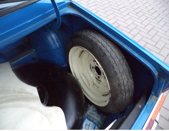

Here you go........
#11 Post by sprint95m »
This is how I intend to site the tank.
Doing this means relocating the spare to a vertical stowage location, which means seem reshaping of the boot floor...
I will need to replace much of the floor anyhow, so not too much of a problem.
There is a bit of storage space (between the tank and back inner panel),
sufficient for golf clubs? Not that I play or have any interest in doing so either!
I believe a KA tank is smaller but have not seen to assess. The plastic ones are (or were?) dear I think.
Also, would there be a suitable fuel pump?
Pictures I saw suggested they are quite narrow so might go in angled to fit, permitting the spare to be flat?
The Fiesta one doesn't do well that way..
Re: Inlet manifold
#12 Post by soe8m »
Had about the same problem after fitting a 70 liter lpg tank next to the petrol tank but solved that with a steel wheel and a civic 13 inch spare tyre.

Ian, hard to get perspective in the pics. Does that tank fit underneath the hardboard cover? If so the vertical wheel may be an option if storage above the tank/board is still viable.
Posts: 6502
Tony.......
#14 Post by sprint95m »
Although the main body of the tank is lower, the high points sit slightly higher than a Dolomite tank, maybe 2 or 3 cm,
meaning the boot does remain viable.
