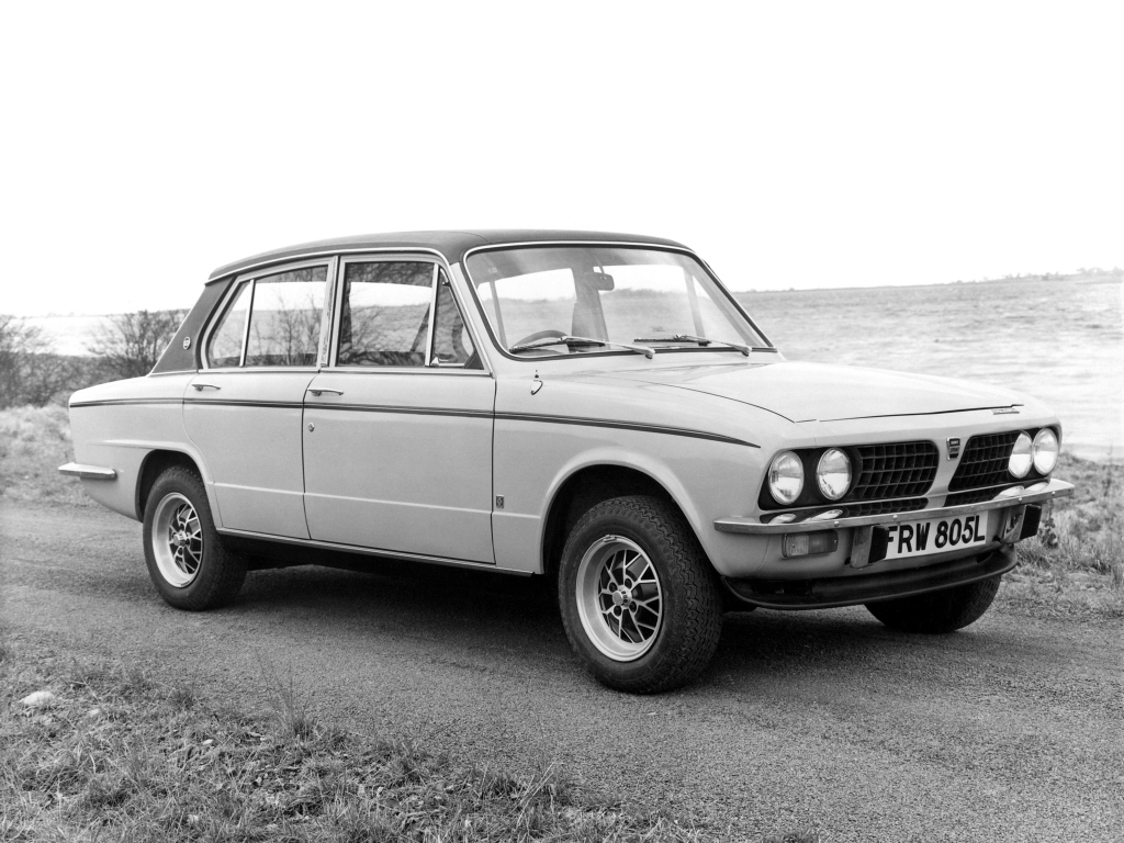

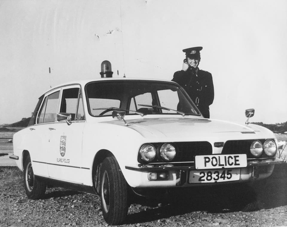

The answer is that they where all dealer fit and there was no prescribed placement. Press cars at the Sprint launch had them fitted on the front O/S wing, Police Dolomites had them all over the car!

- Dolomite Sprint Guernsey Police.jpg (61.93 KiB) Viewed 1373 times
- triumph_dolomite_sprint_press_car_FRW.jpeg (363.93 KiB) Viewed 1373 times

The ariel and position shown on the Sprint press launch car above (FRW 805L) seems to be correct for all Sprints and was gradually adopted for lesser models later on in production. Initially on the launch of the Toledo in 1970 there was no factory fit ariel (or radio) and no hole in the car anywhere for an ariel to be fitted so dealers fitted them where the customer wanted them. Towards the end the radio and ariel became standard and the ariel position from the factory became the o/s/f wing. However, replacement wings were all sold sans hole which leads to varying styles and fitments, even on later cars.

From what I have seen, early ones are at the back and later ones are at the front.
Edit: Having said that the picture above is an early one so what do I know.
