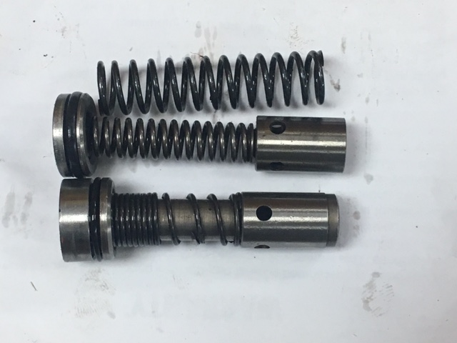

Noticed today that the oil pressure on the Pageant Sprint has dropped. While it has never been high (around 45 when hot at 2500+ rpm) today it was 36 hot and only 24 at tickover. Today was warm at around 25C but coolant was at 82, same as thermostat, all the time. Went up to 90 when stationary at which the fan kicked in and pulled it back down.
It is due an annual oil change (Castrol GTX 20-50) in a few weeks but has only done 1600 miles since last done. Now at 117,500 miles on the clock, of which I’ve done 34,500 over the last 19 years of ownership without anything other than routine preventative maintenance. Doesn’t burn or lose oil and no noises that would indicate concern. No rumblings from the bottom end and nothing from the cam/valves.
I don’t want to start any significant work on the car now, given in a year’s time I will have a lot more time on my hands. Hence I would rather do something short term and perhaps look at a good refresh later.
I have thought about using a different oil, Penrite HPR30 (20W-60) or even perhaps Their HPR40 (25W-70) as they talk about better oil pressure / reduced consumption. There is also possibly the question as to whether the oil pressure relief spring is functioning correctly. I say that as on another Sprint I have had one wear and eventually break. However if I take the pump apart, what do I replace the current spring with?
In my box of bits I have three different springs and two types of fittings. If I read it correctly, Rimmers don’t stock the original type, but do have an uprated one. Not sure if it is even for the Sprint though as the part number 131535UR refers back to the Dolomite 1300/1500. However, I do appear to have one that looks identical to that, as well as a bigger one that is the same diameter as the original but significantly longer. The latter was one I removed from a Sprint that was running at over 100 psi.
The only supplier of ‘original’ type springs I can find is Robsport. They have a standard and uprated version, but can’t ascertain what the difference is (although I confess I haven’t asked them!) Does anyone know or have experience of these?
Any thoughts, experience or advice welcome.
Geoff
Top is the spring that was running at over 100psi and does fit in place of the standard one (one shown at the bottom of the photo) but is much longer. Middle one appears to be the same as the 1300/1500 spring, complete with the different ends that it was with (it will have come from a pump fitted to an 1850, but who fitted it, when and why is unknown). The setup at the bottom of the photo is clearly the only one I can find in any of my three parts catalogues, covering each of the first three series cars. This is an early fourth series car though and I don't have a parts catalogue for that one!

So your top oil pressure relief valve is a Burman type for a Burman type pump, the bottom one is a Holbourn Eaton type for one of their pumps. Robsport supply the Burman type spring. Well that's the one that they gave me!
Re: Low oil pressure and different types of relief spring?
Hope that helps

When I bought the Quicksprint, it too was running off the scale in excess of 100 psi.
I removed the same spring as illustrated top and replaced with the standard graded helix type and it then ran at about 40-45 psi warm idle after rebuild.
Whether the high oil pressure contributed to the early demise of the tensioner and chain, or whether it contributed to the slight play in the jackshaft front end can now only be conjecture...

You only want sixty psi for the valve to open. Higher pressures cause wear in the front jackshaft bearing, which you really dont want. I cant imagine the GTX has gone out of grade after such a low mileage unless you are getting fuel in the sump somehow and its being diluted, so check carb float valves and the fuel pump diaphram
Its not hard to whip the pump off and look for anythig sinister. Wear on the lobes or the spring going weak should be easy to diagnose.
Robsport have issued warnigs about the replacement pump they sell having too stiff a Spring for TR7's and Stags that they mostly deal with and tell you to reuse your old one.
Maybe the club should think about getting some 60psi ones remade?

Thanks everyone, very helpful for my thinking processes. Little did I know I would be entertained with stories of large women in a shoe shop.
So it is a Holbourn Eaton type, but given a spare spring is 12000miles and 10 days away, I haven't had a look inside yet. I have changed the oil and filter, after adding flushing 'stuff' and running with that for 20 minutes. Used the standard Castrol 20W-50 that I've used for decades. Incidentally the oil filter cartridge cost me $33 after my discount. That's around 20 quid! Talk about getting ripped off.
Once hot, idle is around 32psi (was 24) and at 60mph in overdrive 40psi (was 36), rising to 44psi at 4000rpm.
Next I am going to order the Robsport replacement spring and try that, but amidst the Christmas mail, that will not be until the end of next week. Ironically I dismantled another used pump I have lying around and guess what, a broken spring. I have two springs, both broken, so my logic tells me the chances are this car has either a broken one, or one well on its way to breaking.

Received the new spring from Robsport in 6 days, which surprised me given how near Christmas. So took the pump off today and found I don't need a spring, existing one is fine and none of the clearances in the pump are out of spec. Both the inner and outer end floats are at the max of 4 thou and there is quite a bit of fine scoring. However, that doesn't look any worse than a couple of other old pumps I have lying around.
So it might be indicative of wear within the engine which I can tackle in a years time, but not now. So will put everything back together and keep a watchful eye out for any further drop. I'm unlikely to do more than 1500 miles in the next year so fingers crossed.

Got around to fitting the new spring and reassembling the oil pump yesterday evening, finishing it off today. Interesting that the O-ring between the two halves of the pump was much thicker than standard so replaced with the thinner version.
Further improvement so that when engine thoroughly hot, pressures are now 33 @ 650rpm tickover, 38 @ 1000 and 48 at 3000.
I'm happy enough with that for the moment, but will have to keep an eye on it. I must admit though to being surprised how much difference a change of oil and PRV spring has made, especially when there appeared nothing wrong with the oil or spring that were there before.
