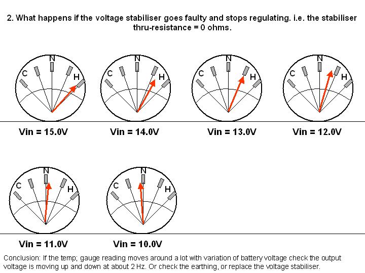

Another way of getting the water temp; gauge to read higher would be to swap the 10V nominal stabiliser for a 12V electronic one. ( 7812 from Maplins ) would probably be O.K. except the voltage overhead at 13.5V input is a bit low. The trouble is the fuel gauge will read high as well.
To give you an idea of what the gauge increase in reading would be it would typically rise from 1/2 way to about 3/4. Here is a part of the article I wrote on it recently.

i did think of your excellent post Tony, but the fuel gauge being higher would give me false happiness :)
