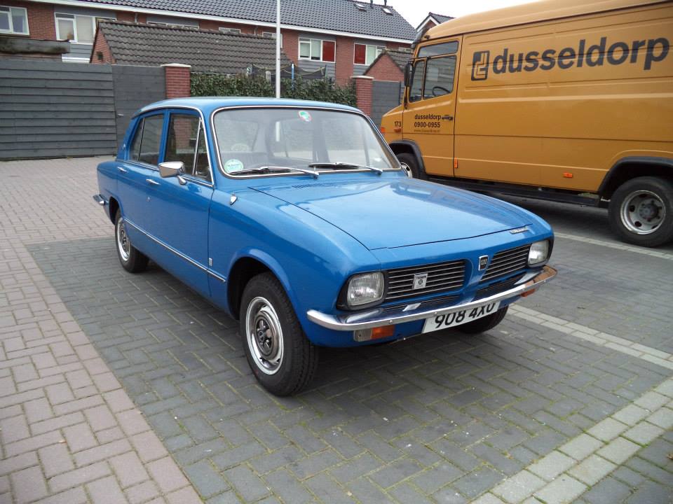

I use for the 155 size kumho light truck tyres. No roll, very comfortable and period look. Before anyone say's too rigid for a dolomite I can say no they are not.
- dol1300.jpg (93.57 KiB) Viewed 2059 times
