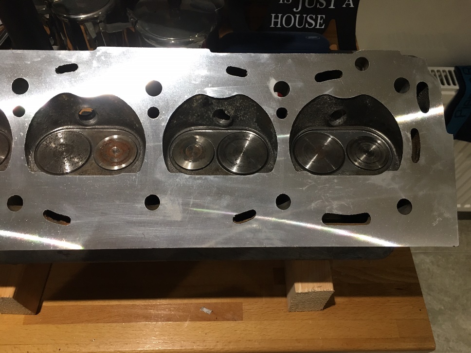

My cylinder head has returned from the machine shop (Head Line Mk Milton Keynes) £38 +VAT.
I am not sure if this is an 1850 head or a TR7 head, perhaps somebody could advise?
The 1850 head in the Haynes manual seems to show a 3 - 4mm step from the gasket face to the valves and this head doesn't have that but it may be a later design as it has the larger valves.
If it is a TR7 head will it fit the 1850 or are there piston cutout issues, compression problems etc?
Many thanks
Malcolm

Re: 1850 Cylinder Head skim
Jeroen posted pics of the various heads in a thread a while ago...
Previous thread on 1850 heads here:
http://forum.triumphdolomite.co.uk/vie ... 4&t=32449
