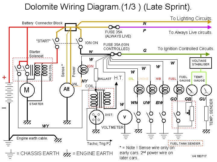

Hi Kyle, yes, I'd be inclined to agree with your diagnosis of the solenoid being faulty for both problems.
See the relevant part of the wiring diagram herewith. The reason the starter motor sounds like a hair-dryer is that it is running, but the heavy duty contacts at the back of the solenoid are not making contact or are burned out or really old and dirty and need cleaning. So what happens is that the current flows from the battery through the relay ( I seem to remember you have one of those fitted) and through the pull-in coil of the motor and then through the motor armature which starts to rotate. But since the heavy duty contacts are not closing the solenoid is not pulling the gear into mesh and the starter does not run at full speed.
And the reason that starting is now difficult is that the switching contacts for the ignition ballast resistor are also not operating. These are also at the back of the solenoid. So a double dose of trouble with a common cause. The ballast resistor wire and contacts are the ones labelled WY btw.
HTH,
