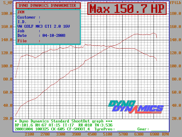

Re: Sprint peak torque and power issue
One of my favourite engines, the ECU restricted to 150bhp VW ABF MK3 Golf GTi engine:
- ABF.gif (18.54 KiB) Viewed 2033 times
Which I read off the graph as 133 ft lbs - over 3 percent more than the "low torque" Sprint engine gives! And all it takes is twin cams and injection.
I realize that a 16-valve engine will give the same torque as an otherwise identicle 8-valve engine at lower rpm, but more torque, and thus more power at higher rpm. That's almost exactly what we have and see with the Sprint and TR7 engines.
Official figure is 132 lb.ft/4800rpm with its twin cams, injection and computer controlled ignition. There was always the myth that the 8v engine had more torque low down, which is utter bollocks and as you say the lighter internals and lower inertia makes the 16v keep on delivering more when the 8v runs out of puff. Posted the graph because I thought it's an interesting comparison, and I'm very familiar with the ABF.GrahamFountain wrote: ↑Tue Feb 20, 2018 9:34 pmWhich I read off the graph as 133 ft lbs - over 3 percent more than the "low torque" Sprint engine gives! And all it takes is twin cams and injection.
Graham
