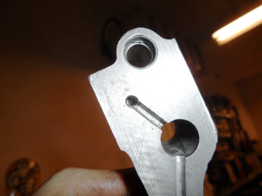

Sometimes (almost every time) the blanking plug is pressed in by the factory too far and blocks partially the oil feed.
Jeroen,
Looking at the plug from the outside, how far should it be set in? Ie from edge of the bearing cap.
The original cam and fingers ( still using the original fingers ) had done over 100,000 miles with virtually no wear, so I’m assuming the oil supply was probably ok.
