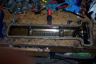

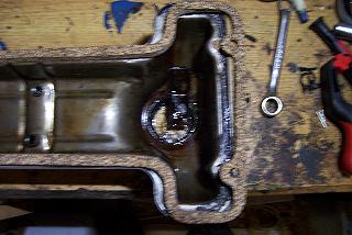

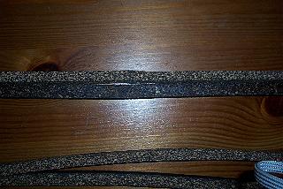

I needed some bits so I thought that I would get them from Robsport and include a cam cover gasket.
Sure enough, as you can see from the photo below, it is thinner.
However, as the other photos show, it is too long.
Luckily I have found an old gasket in reasonable condition that seems to fit.
