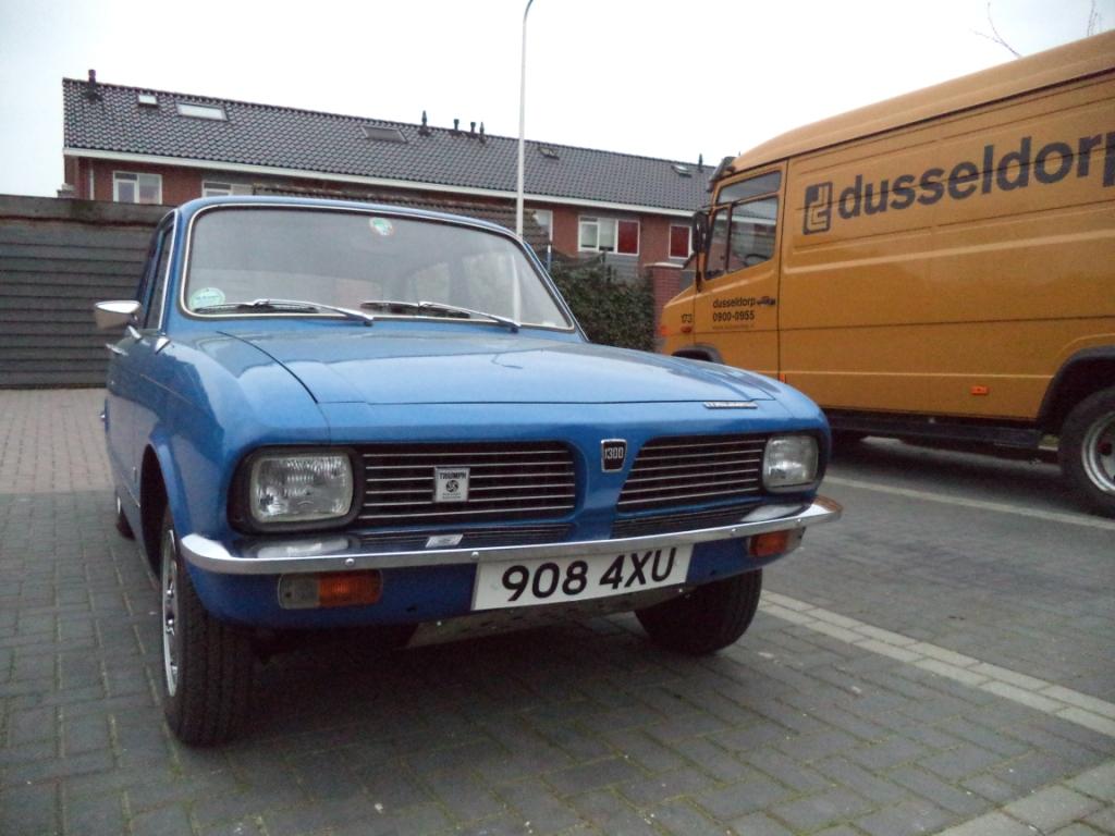

I use kumho light bus tyres. 155/80/13. These have an old pattern look alike and are very good in the wet and dry on a dolomite. These are on my 1300 and the firmer side wall cause less roll and flex and give better handling as the "normal" tyres. They are as comfortable as normal tyres.
- DSC00383x.JPG (109.64 KiB) Viewed 3068 times
