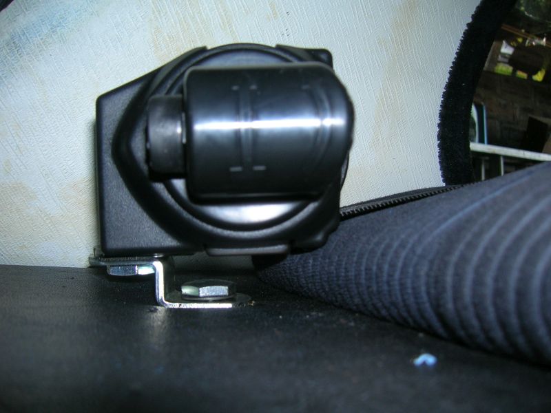

I have just put the Securon belts in the back of mine too. Like in the article mentioned above I mounted the reels on the dog-leg bracket to allow the belt freedom of movement over the top roll of the seat. See the photo.
- RearBelt.JPG (93.92 KiB) Viewed 1323 times
