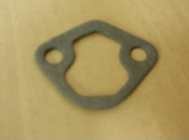

I had the same problem on my Sprint, bought a new pump which came with the usual thin gaskets,
but ordered at the same time a thicker gasket just in case, and yes it was needed, (from Robsport).
Pic of the thicker one, its about 2mm, compared with the thin one at .05mm.
