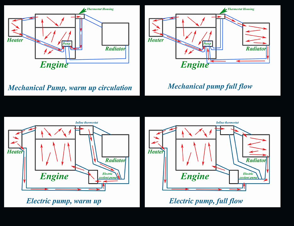

Hi James, Sorry to hear about these problems. Just to add to what has been said ..you need the thermostat with the protuding foot that operates when it is hot. Adverts that say "fits Triumph Dolomite " . Well yes it "fits" but may not work as intended.
Here is why as illustrated by Iain Sprint95m on here.
One other thing worth doing is ensuring the small hole in the thermostat housing is clear. It goes to the smaller bore pipe to the top RHS of the radiator. I think this is an air bleed to allow air to escape. This hose should be full of water if disconnected briefly.
Interestingly, this bulging of the hoses you describe are typical of head gasket failure. I had exactly this on both Sprints and most recently on the 1850, particularly has the heater is running cold. But yes do have a look at the heater hoses / valve first.
- sprint95m waterflow.jpg (391.34 KiB) Viewed 2525 times
