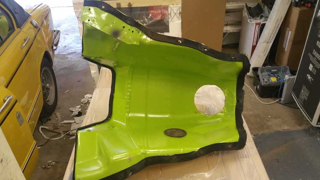

I used a neoprene sponge which is waterproof when compressed, roughly 15mm thick from Ebay.
The self adhesive was not doing a good job, so a bit of glue and some bulldog clips helped stick it down overnight.
The picture was taken after removing the tunnel to change a O/D switch, and put back with no extra works to the strip.
- 20161018_154024.jpg (236.38 KiB) Viewed 2462 times

Re: Gearbox tunnel sealing
The neoprene foam idea is spot on. I think I might go with that.
